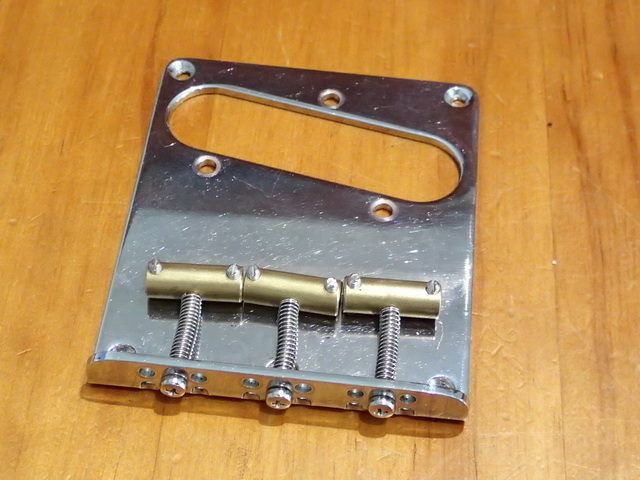

    Hey Simon dont know if you thought about putting new saddles in that bridge? i did this mod to an Affinity bridge, works a treat.

    Hey Tony yes I actually thought of brass saddles but I actually prefer the six individual adjustable ones for perfection intonation. Thanks for the tip.
    No such thing as perfect intonation... but i get what your trying to say
