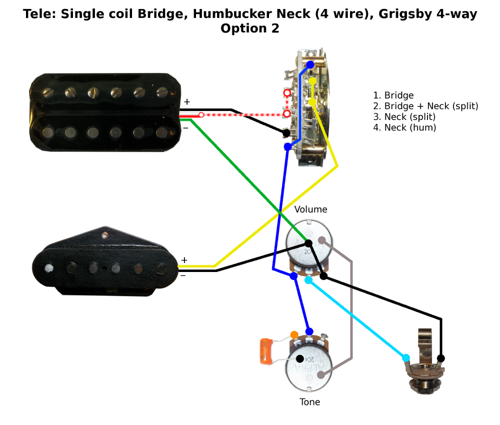

    Bridge with split neck in position 2, and split neck in position 3 (red & green coil active when split):

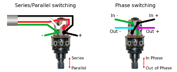

    Push/Pulls can also be used for series/parallel switching instead of a toggle switch, or even for phase switching if you want a scooped nasally sound when your pickups are combined. A push/pull is also an easy way to add coil splitting, as you can directly control which coil is active (let me know if you need a diagram for that).

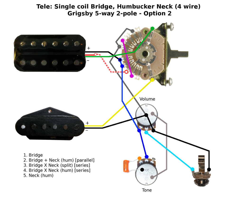

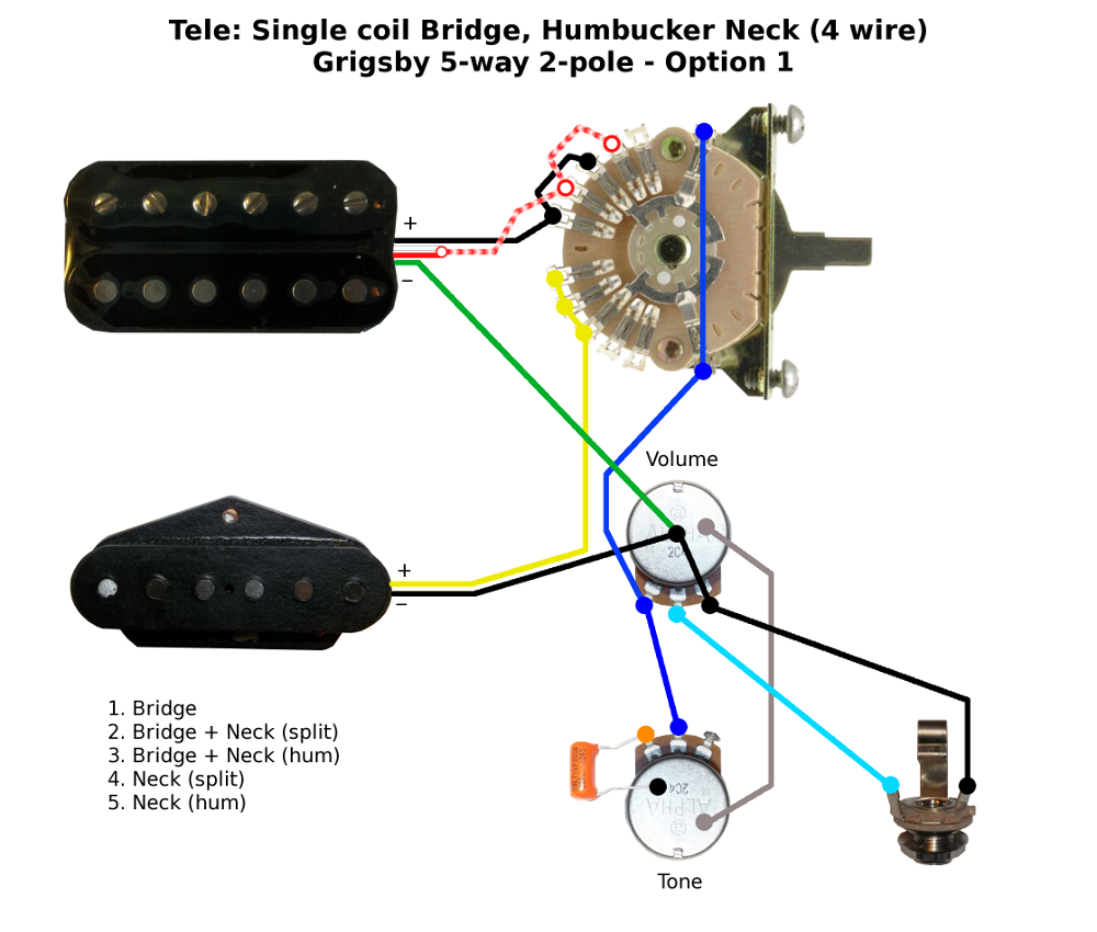

    5-way switches give you even more flexibility, but each position needs a separate lug for the wiring to work. So, you can't use a standard CRL style 5-way where positions 2 and 4 bridge two lugs. Instead, you need to use larger separate lug switches like the Grigsby 5-way 2 pole and 5-way 4 pole.
    5-way 2-pole Grigsby Lever switch diagrams
    The 5-way 2-pole is a fairly large switch, so the stock PBG Tele cavity may need to be deepened slightly.

    Bridge with split neck in position 2, and split neck in position 4 (red & green coil active when split):
    Bridge in series with split neck in position 3 (black & white coil active when split):

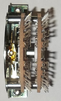

    The 5-way 4-pole is a much larger switch with the addition of a second wafer. It will squeeze into the opening of a PBG TL cavity, but the cavity will need to be deepened and, in my experience, a bit taken out of the side wall (like an undercut) to ensure clearance when the switch is in position.
    With so many lugs it's difficult to show how to wire the switch with an actual image, you can't see all the lugs from any one angle. So, I've modified a side view with the inner wafer sticking out so that all the lugs are visible and you can see, mostly, where the connections need to go.

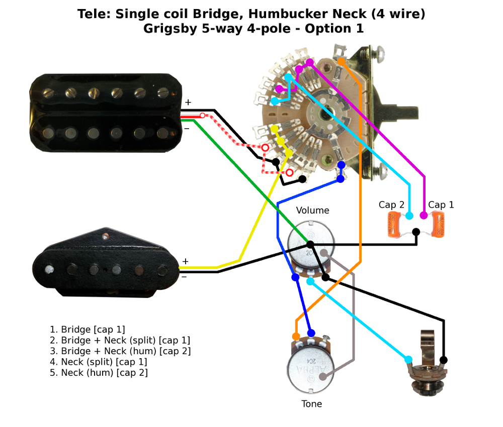

    The extra poles on the switch means that you can also do things like having different tone capacitors for different postions/pickups. So, in all of the following examples, one of the switch's poles is used to select between two different capacitors, cap 1 for single coils/split, cap 2 for humbucker combo's.

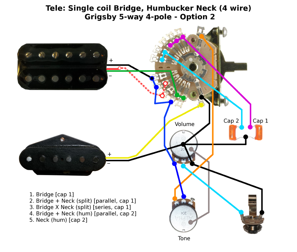

    Bridge parallel with split neck in position 2, and bridge in series with split neck in position 3 (black & white coil active when split):
