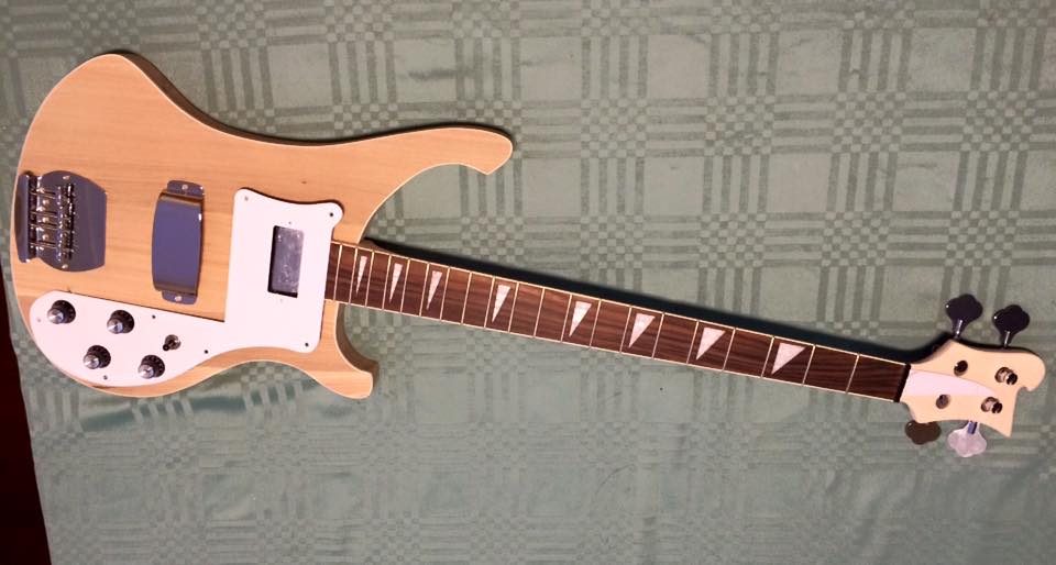

    Alright, the Kit is here! Took a bit to arrive as Australia Post for some reason felt that it should visit Brisbane after a brief stint in Sydney before coming back... Anyway.
    So, following the advice on the forum I thoroughly checked it and all looks good. All parts are here and appear correct, no glue spots or other nasties. I was concerned about what looks like a machining / screw mark on the front but then realised and 1- it would be covered by the bridge and 2- all other pictures I have see have the same, even on PB's website so it probably is normal.
    I did a quick mock putting all parts roughly where they are supposed to be. Looks exciting. Love the wood grain, particularly on the to part which luckily won't be covered by the pick guard.
    I do have one concern / question with the neck. Is it supposed to be pushed back all the way into the cavity? It fits quite nicely but the the start of the fretboard appears to be too low and the pickup / pick guard don't seem to fit properly if setup this way. Looking at other builds of the same model though, the last fret seem to be in line with the top part of the body (per the last picture) which would suggest that the neck is not pushed all the way but it doesn't seem quite right.
    Is this normal? if so should the neck be all the way in (per pic 2) or pushed up a bit (per pic 4). Sorry if it is a silly question - I did say I was a total newb - but if someone could share their views that would be a great help!

    Member Swanny's Avatar
    Sep 2015
    Morayfield, Qld
    482
    Glad your kit arrived! I think one way you could check the neck position is by measuring from the nut to the 12th fret, and then to the bridge. The 12th fret should be the halfway point.
