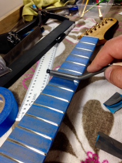

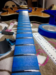

Final work on the frets - after leveling and waiting for the crowning file to arrive, I've now crowned and polished them all. I then sorted out strong height, truss rod, pickup height, and intonation on the tune-o-matic bridge.
I'll make some more small adjustment before putting good strings on. SO close to being finished!!

Crowning
(big picture: https://goo.gl/photos/Fu7r21K9VMtGN7TJ9 )

After polishing
(big picture: https://goo.gl/photos/BJWBZUZBoZGof2Rj6 )
