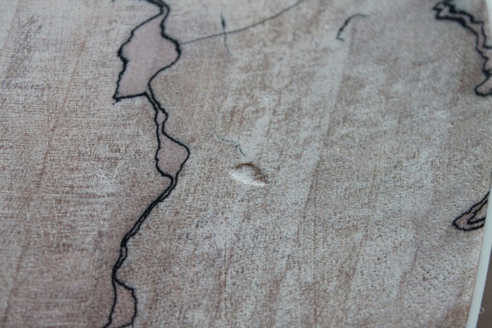

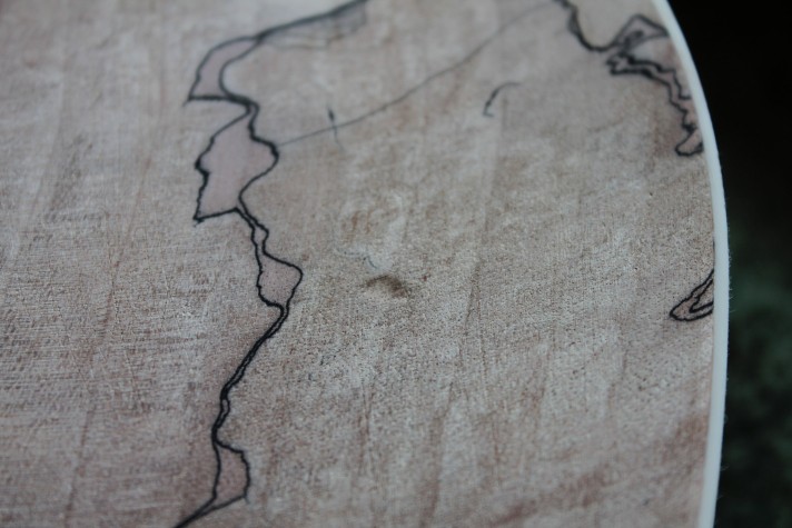

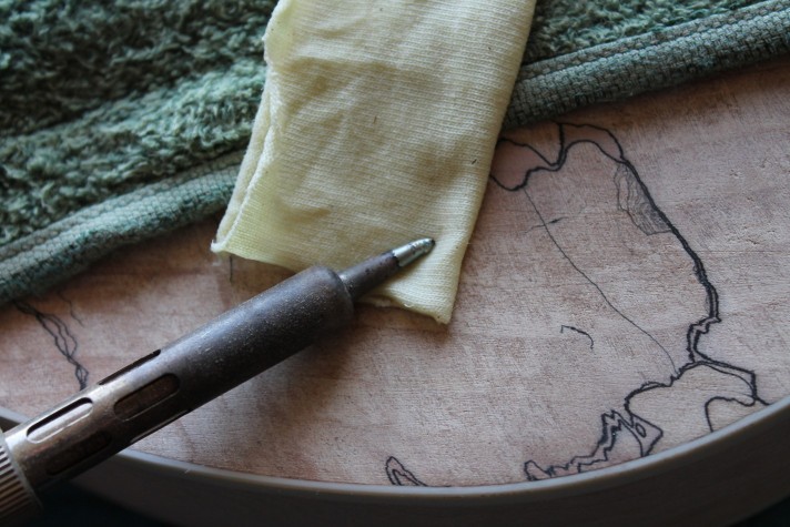

    here is a dent that would prove fatal if I tried to sand it out.
    Solution? steam the bugger out.
    For this process, I need a damp rag, pipette and soldering iron set to around 100 degrees C.
    First I place a drop of water on the dent and let it soak.
    Then with the damp rag I start to steam the area.
    After few minutes, the dent is reduced by 50%, once the surrounding areas had dried out it was reduced even more.
    Now I can sand it out without ripping through the cap.

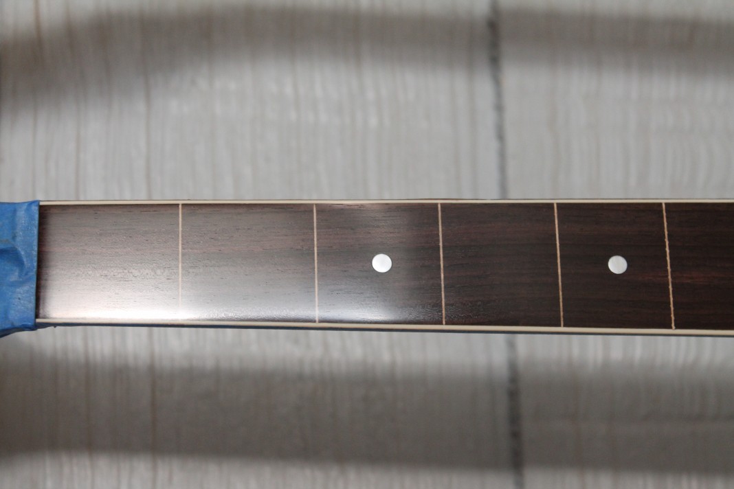

    And now for the fun bit...
    Ripping out those pesky speed humps!
    I re radiused the finger board and back filled the slots with Timbermate.
    Then a coat of thin CA glue, sand down to 220 and repeat twice.
    Next I sand up through the grits to 1500.
    Once I wax and polish it will shine

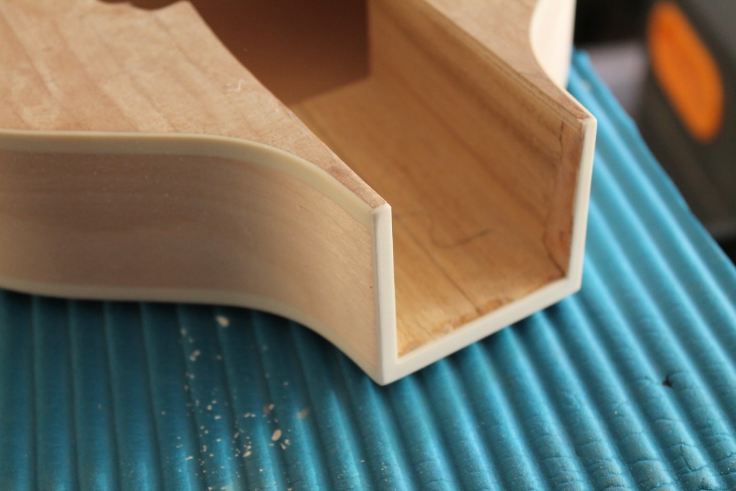

    And now for a few cosmetic touches...
    For some reason, the factory neglected to bind the ends of the neck pocket..... YUK!
    Soon fixed that.
    Notice that I left the over hang on the outside of the body rather than inside the pocket.
    This makes it easier to trim.
