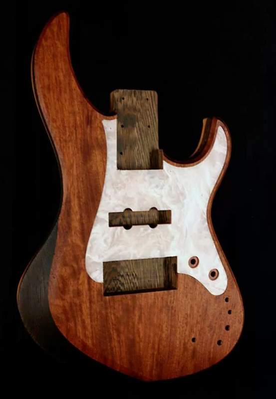

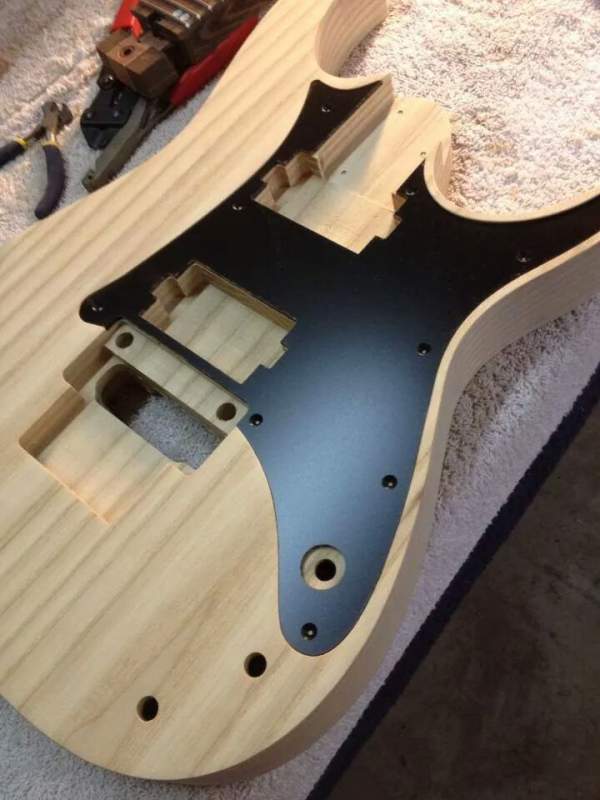

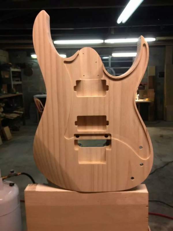

    It's a great idea. I've seen it done and it looks fantastic. So clean.

    With a pearloid guard, it looks like inlay. Which it is, technically. I guess.

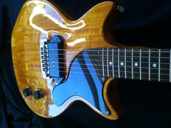

    Hi Scoop, not exactly what you were planning but I wanted my pickguard to sit flat on my JR-DC so I had to countersink it at the crown of the arch-top.
    I just used the guard as a template and chiseled and carved it all out by hand until it was sitting flat.
    rob
