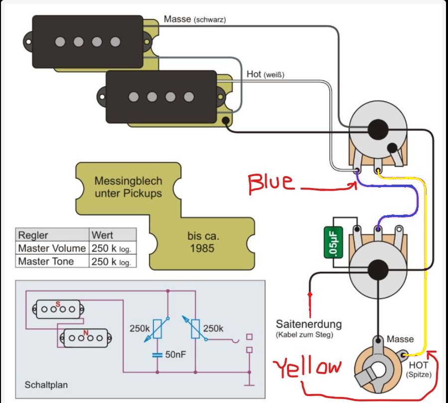

    This one is a little clearer...
    It's in German, but there's not much to translate: "Masse" refers to "ground" or "earth." The other is "Saitenerdung" this means "bridge ground wire"
    I like this chart better because it shows the ground wires which the PitBull diagram does not.

    ...the stray black wire which is attached to the tone potentiometer (pot), is for grounding your bridge. Here's a video of someone doing that:

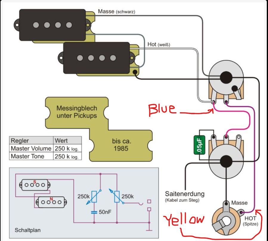

    Shielding looks good!
    Ground wire to the bridge looks good too, although you could just use the black wire that is already attached to the back of the tone potentiometer (pot). Or you can just attach the new red wire to that black wire.
    I think I see the problem on the tone pot. It looks like the yellow wire should be attached to the middle lug of the volume pot, rather than the tone pot. The yellow wire should go directly from the middle lug of the volume pot to the jack.
    The blue wire and capacitor look correct, but the yellow wire should not go to the tone pot or touch the blue wire. Sorry I didn't catch that earlier!

    Y saludos desde Miami ;-)
    I will do it that way
