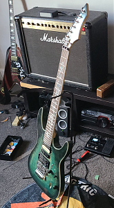

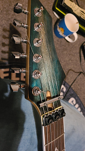

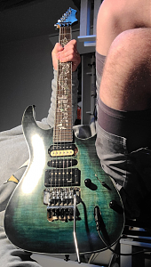

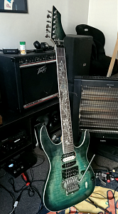

    My IB-1 kit finished to a point I'm happy with! finished with wipe on polyurethane to shine. The edges of the fret board have been rounded off to smoothen the feel as well as a slight "fret fall" from the 12th fret on resulting in an action of 1.3mm at the 12th fret on the high E. Plays beautifully! Upgraded hardware and it sings. Perfect intonation and a lovely light weight feel, my current axe of choice 😍

    Beautiful work, love the swampy green look, what did you upgrade hardware to?
    I upgraded the bridge and tuners to Gotoh products (the bridge a Gotoh ge1996T)
    And pickups are an Alan Entwisle neo dymium darkstar in the neck, with an esp pickup I pulled from another guitar... will prob
    Will probably replace later on. My bad, pressed enter accidentally
