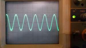

    I've got the app set-up to generate a 1000Hz (1kHz) Sine wave signal, here's what it looks like on the Oscilloscope screen display:
Name:	1K Sine_resized.jpg
    A 1kHz Sine wave signal is a useful test-signal because 1kHz is right in the middle of the audio spectrum, which normally ranges from 20Hz-20kHz, a Sine wave is one of the purest signals you can generate because it is usually just one frequency and very little extra harmonics (a harmonic is a signal that is related mathematically to the fundamental frequency, in this case 1kHz is our fundamental frequency).

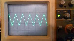

    Here's what a 1kHz Triangle wave signal looks like on the Oscilloscope screen:

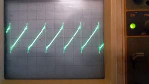

    And here's what a 1kHz Sawtooth wave signal looks like on the Oscilloscope screen:
Name:	1K Sawtooth_resized.jpg
    Notice how our 1kHz Sawtooth waveform has a bit of ringing at the top and bottom sharp corners?, that's because it is a digitally-generated Sawtooth waveform, a Sawtooth waveform generated by an analog circuit doesn't have that ringing, but for the purpose of this mini-tutorial, the digitally-generated Sawtooth waveform is good enough.

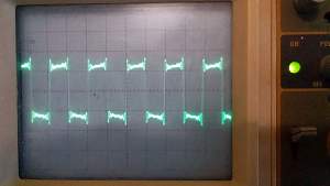

    Finally, here's what a 1kHz Square wave signal looks like on the Oscilloscope screen:
Name:	1K Square_resized.jpg
    Again, we see ringing on the top and bottom of the waveform due to it being generated digitally:

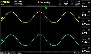

    There's one cool, and very handy feature included in my new FNIRSI 100MHz Digital Scope/Function Generator, well, two actually, firstly it includes a built-in Function Generator that generates several different signal waveforms at a wide range of user-adjustable frequencies, secondly, you can take screenshots of what you see on the display, here is an example, the yellow trace is Ch-1 and the pink trace is Ch-2.
    The new Digital Scope also displays readouts of various waveform parameters too, like frequency and amplitude, this saves having to do calculations.
