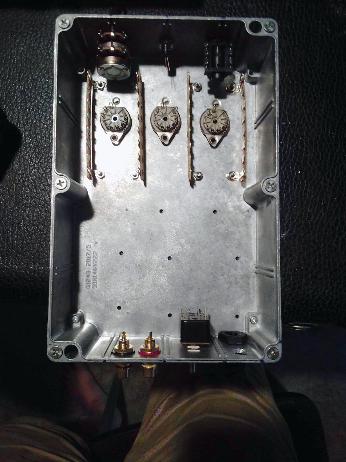

    Update:
    I managed to make some more progress on my 6N1P OTL Headphone amp project over the weekend, did all my marking-out of the diecast aluminium chassis, and drilled all the pilot holes, I used a stepped drill bit to enlarge some of the holes to the correct size, but I'll need to wait till next fortnight to buy some hole saws from my local Bunnings store, to cut the holes for four can caps that will mount on the chassis top near the power transformer, here's a couple of pics showing the progress I made, won't be too long till I can do all the final assembly, wiring-up, and testing work:
Name:	6N1P OTL Headphone Amp Chassis_1_resized.jpg
Name:	6N1P OTL Headphone Amp Chassis_2_resized.jpg
    Top pic shows the chassis all marked-out, I may need to drill a few more holes in it though, second pic shows the insides of the chassis with some components, and tagstrips mounted, mostly so I can get an idea of how it is all going to work, I'm happy with it, had to go through a few revisions of the chassis layout till I came up with this layout which seems to work really well.

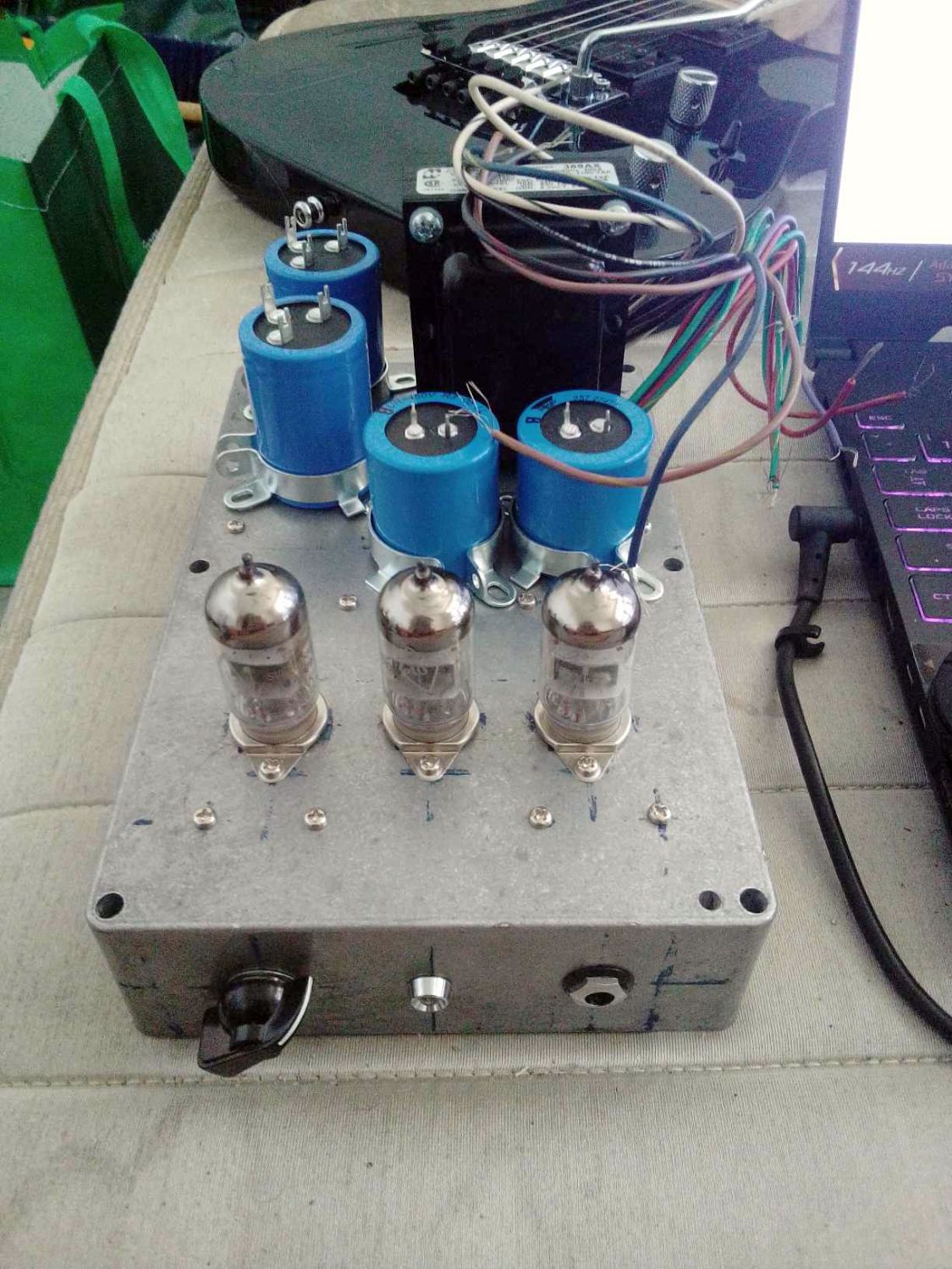

    Update:
    Made some more progress on this build project, managed to get the mounting holes for the fuse holder and tube sockets drilled out to size, the can caps sitting on the chassis are just to give an idea of how it's going to look once the final assembly has been completed, I'm not going to be using those two taller light-blue can caps, I'll be using two black MLytic dual 50uF/500V can caps instead:
Name:	Tubes Fitted To Chassis_resized.jpg
    The two shorter can caps are the two 470uF/450V DC output coupling caps that couple the output signals on pins 3 and 6 of V2 and V3 to the headphone out sockets, pins 3 and 6 of V2 and 3 will be sitting at about half the full B+ HT supply voltage (about +348V DC), or about +176V DC, so, the voltage rating of the 470uF can caps needs to be high enough to withstand it, that's why I chose 450V DC can caps, 450V DC should be more than enough for the job, the last thing you want is your headphones copping 176V DC across the voice coils, which would burn them out in an instant, it is always a good idea to over-rate the caps for the job in a Tube amplifier for reliability's sake, sure, it may cost a little bit extra but well worth it in the long run, by over-rate I mean use caps with a voltage rating a bit more than what you're expecting to see in the circuit, in some cases you can get-away with using a cap that's the next value up from that specified in the circuit if the specified value is unavailable, most electronic circuits aren't all that critical when it comes to component values.
    In the original 6N1P OTL headphone amplifier schematic, the output coupling caps are two 220uF caps in parallel, which gives a total of 440uF, since space in the chassis I'm using is a bit limited, I wanted to reduce the number of output coupling caps to one for the left channel and one for the right channel, now 440uF isn't exactly a common value of capacitance so I opted to up the value to 470uF, which is more common, it may result in a more extended bass range, but I reckon it should work fine.

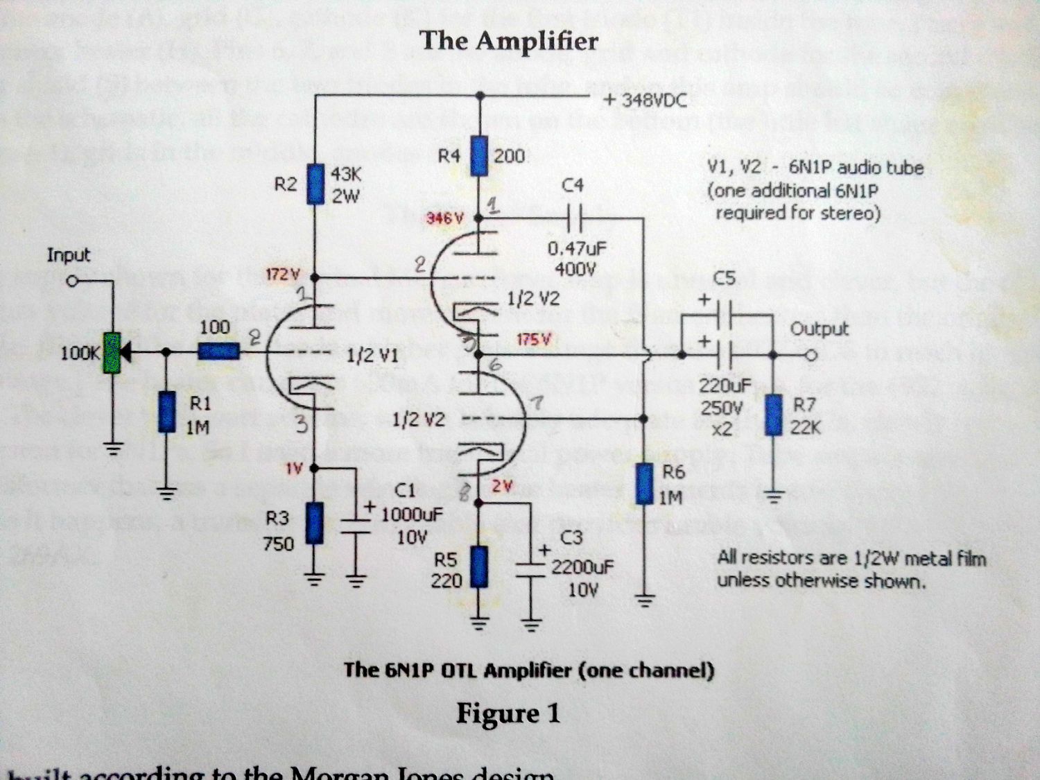

    How about we do a quick analysis of how the main amplifier circuit works?.....I won't go too heavily into the mathematics though...
    Okay, looking at the schematic, the signal from our audio-source comes into the amp via the input sockets, and appears on the clockwise tags of the dual 100k Log volume control, the dual 100k Log volume control acts like a variable voltage-divider with the signal level on the wiper tags proportional to where we set the volume control, the signals are applied to the junctions of the 100 Ohm and 1M resistors connected to pins 2 and 7 of V1, the two triode halves of V1 are configured as common-cathode amplifier gain-stages, both of them have a 42k/2W anode resistor and a 750 Ohm/2W cathode resistor, these two resistors set the quiescent, or no-signal, operating conditions of the gain stages, the input signals applied to pins 2 and 7 of V1 appear on pins 1 and 6 of V1 amplified but inverted, pin 1 of V1 is direct-coupled to pin 2 of V2, and pin 6 of V1 is directly-coupled to pin 2 of V3, V2 and V3 are configured in a circuit topology known as a White Cathode-Follower circuit, a cathode-follower has a gain of 1, or slightly less than 1, but it provides current-gain and a lower output impedance (my guess is that the output impedance is most likely about 10 Ohms or so), this is important because the output impedance of the two gain stages of V1 is high, and if we try to drive a low impedance load via a high impedance output, we will get a much lower and distorted output because a high impedance output cannot supply enough current to drive a low impedance load.
    The two White Cathode-Followers formed by the two halves of V2 and V3 have a 200 Ohm resistor connected to pin 1, and a 220 Ohm resistor connected to pin 8, V2 and V3 also have their pin 3 connected to pin 6 which are connected to their respective output coupling caps, one other thing about cathode-followers is that the output signal is in-phase with the input signal, the 200 Ohm resistor and 220 Ohm resistor, as well as the 42k resistor, all set the quiescent operating conditions of the White Cathode-Follower output-stages formed by V2 and V3, in order for the OTL Headphone amp to be able to drive impedances down to 32 Ohms, the White Cathode-Follower output-stage has to be properly balanced so that the top triode has a gain of unity, or 1, otherwise excessive second-harmonic distortion will occur when the amp tries to drive low impedance loads, the amplifier itself doesn't really need to be very powerful since you only need tens of milliwatts to drive headphones to a good volume level.
    Pin 7 of V2 and V3 is tied to ground via a 1M resistor, and a 470nF/630V cap couples the signal on pin 1 of V2 and V3 to pin 7 of V2 and V3, essentially, V2 and V3 act like a kind-of push-pull output stage.
    The signals on pins 3 and 6 of V2 and V3 are AC-coupled to the headphones via the coupling caps, which, in my case, are two 470uF/450V DC can caps, they block the +176V DC on pins 3 and 6 of V2 and V3 and pass AC signals.
    The 1000uF/16V cap in parallel with the 750 Ohm resistors, and the 2200uF/25V caps in parallel with the 220 Ohm resistors are bypass caps that allow each stage in the amplifier circuits to work at their best.
    Here's the amplifier schematic for reference:
Name:	6N1P OTL HP Schem_resized.jpg
