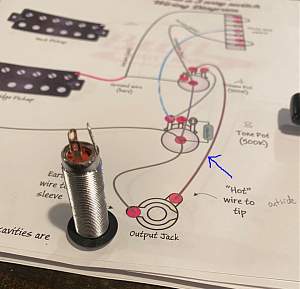

    I'm confused on how to wire the output jack.
    1. Is the hot/outside tip the longer of the 3 tips on the end of jack?
    2. For the inside/earth contact does it matter which of the 2 'short' tips you solder to?
    3. In the diagram, my blue arrow is pointing to a wire that doesn't exist in my set of electronics. I think I have an extra wire (yellow) that is already attached to the tone pot, so can I just remove that and use it for this blue-arrow wire?

    re: Q 1 & 2 - The longer solder lug on the outside is your ground. I believe the jack you have there is a TRS (stereo). If you have a multimeter and a stereo plug you can test it to confirm. If it is a stereo jack you can simply jumper the two centre lugs with the positive signal wire and it will act as a mono jack.
    re: Q 3 - A picture of the existing wiring would make it easier to determine whether it is actually "extra" or where it should soldered to.
