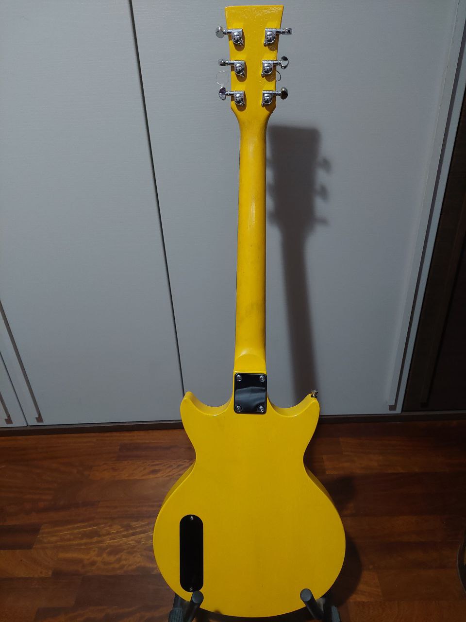

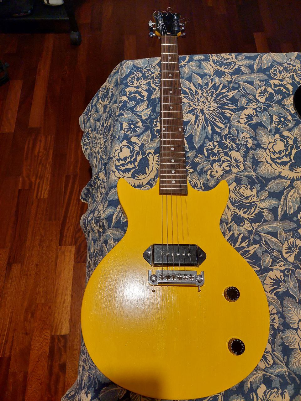

    Hi everyone, it's been a while but I completed the build!
    It was tougher than I thought, there are many flaws and imperfections but I'm happy with the result:

    But now I have a problem with the neck, the first three frets are unplayable, strings touch the fretboard completely, the action is high beyond the 7th fret but too low in the first frets - I tried to unscrew the truss rod to his limit, now it's a bit better but strings still touch when I play on first frets - maybe do I have to lift up the bridge a bit? Or maybe does the neck have problems(faulty)?
    Also I have to raise the pickup for sure because is too far from strings but shouldn't be difficult(I hope).
    Thank you for the support!

    Could be any number of things or a combination of all of them. Do you have a notched straight edge? Or even a long regular straight edge? It's an easy way to see how much (if any) relief you have. It sounds like you might still need to ease off the truss rod a bit more but it's better to check it rather than guess. Also, keep in mind that you want to do small adjustments and then wait as it takes a while for the strings to pull that neck up once you loosen off the truss rod. It might be overkill, but I generally like to wait 24 hours after an adjustment before I'll make another one.
    Usually, if the bridge is too low, you'll get buzz or worse across most frets, but I wouldn't rule that out either. If you fret at the 1st and last fret (using a capo or two is easier for this test), do the strings ring out if you pluck between the two fretted points?
    Oh, I just read that you said you adjusted the truss rod out to the limit. Well, assuming you've given it time to settle into place, I'd be checking with a straight edge. You should have plenty of relief if you've loosened it right off. If not, might be worth seeing what your options are for a replacement. Not sure how you'll go since you've finished it, but no harm in asking the question.
