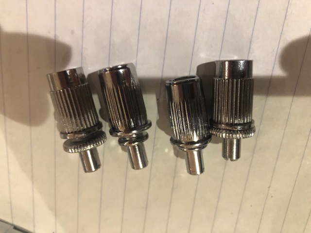

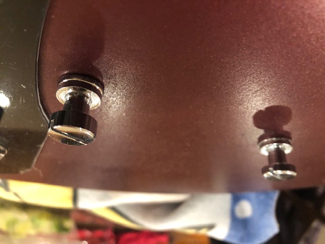

    Getting ready to put in the posts for the bridge and tailpiece on my double neck SG style, and I see that there are different posts, 2 of each. The tailpiece post, the screw is thicker on on two of them, and the bridge posts...two have the notched dial on the screw and two do not.
    How are they supposed to be configured? Do same go with same? Do specific ones go with the 12 string side and another the 6? Do you use one of each on each neck? I have seen pics where the notched dial post on the bridge goes on the low e string side, and the the non-notched dial post on the high e side. If that is the case, then does the thinner screw post on the tailpiece go on the notched dial side?

    I'm not familiar with the kit, but it looks like the bridge posts are two slightly different heights. Which means that the height of the two bridge bodies are likely to slightly different as well. If both posts fit into the holes in the bridges, then you'll probably find that one set sits pretty much flush with the top of the bridge body, and the other will be either be slightly proud or slightly sunk in comparison. Match up the posts that sit as flush as they can.
    The 12-string and 6-string bridges will be sourced by the factory from different suppliers, hence the two styles of bridge post.
    You should use the same type of post design on the same bridge. One style of posts is the older Gibson-style design where height adjustment is done by the knurled thumbwheel. The other is a more modern style where height adjustment is done buy using a screwdriver in the slotted posts. The latest Gibson bridges use a hex key socket in the top of the post for height adjustment.
    If both post designs are the same height and both of the posts fit the bridge holes equally well, then make your own choice as to which goes where.
    The height of the 'screw heads' on the stop tailpiece poles again varies because the bridges have come from different suppliers. I've bought loads of bridges and tailpieces in my time, and the tailpiece studs tend to come in either thicker and flatter, or thinner and rounder versions. If the gap in the slot between the screw head and base is the same on both types, then it really doesn't matter as to which tailpiece fits on what pair, But use the same type as a pair on a tailpiece. If the slot gap is different (but they are almost always the same), then see which tailpiece fits each slot better. You're best having them so that they fill the slot in a similar manner, not one sitting pretty tight in the slot and one quite lose.
    Hope this makes sense.

    Thanks Simon, makes total sense. Feel dumb that I didn't notice this myself.
    I managed to match the bridges with the posts and the the tailpieces with the bridges. The notched wheel posts matched up with the 6 string bridge, the taller posts with 12.
