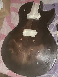

    I have watched quite a few videos on staining, the back of the guitar went well but it all went wrong on the front... when I tried to blend the colours... also I think I may have sanded too much. I think I have gone through the maple top around the edges.
    This is the best I have managed...
    Name:  stain finished.jpg
    NOt really happy with it... I have been playing around trying to fix it but I don't really know what else to do.
    It might look ok with a high gloss coat but it's not exactly what I had in mind.
    I am toying with the idea of just painting it all cherry red. I will lose the maple grain but I will buy another eventually and hopefully won't make the same mistake with that one... and use a different colour. This is not what I imagined it like.

    I can't see the result too clearly in the picture, but if you are using water-based stains, you could try to soften the light to dark colour transition using a damp clean rag, by rubbing that part of the burst with the contour line.
    What is the look you are after?
    I hope you'll be able to fix it, but cherry red could be cool!?
    Ps. I also went through the maple on my guitar as well but was able to camouflage it in the darker colour of the burst.
    Hope this helps.

    Quote Originally Posted by RocknRolf View Post
    Hi Mark,
    Hope this helps.

    I decided to carry on with the stain and see what I get, I can always paint over it if it doesn't come outright.
    This is how it looks at the moment, a better pic than the one above.
Name:	my build.jpg

    I hope you'll be able to water down the center and apply the orange tint of that studio to 'pop'. Could turn out really cool around the bridge area!
    Good luck!
