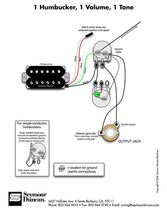

This is my first time building and wiring a guitar, and I'm a little turned around with the wiring diagrams. As there is none listed for the IB-4 specifically, I grabbed the IB-5 wiring diagram, as it is the same 2-humbucker, 4 pot setup, a tone and a volume per. Here's the diagram:
https://www.pitbullguitars.com/wp-co...s/pdf/IB-5.pdf
problem is, those aren't the wires coming out of my pickup. Searching the forum brought up a bunch of discussion as to why this is and how to sort it out, which I'll have to walk myself through it a few times before I get it.
However, my forum search also brought up this diagram for a single humbucker, single volume, single tone:
https://www.buildyourownguitar.com.a...1&d=1418177358
And it strikes me that just doing that for each pickup and pot grouping, connect both sequences to the input jack, and ground both volume pots to the bridge. Will this work out how I think it will?
