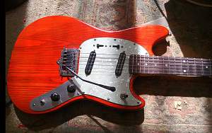

    I used ebony Timbermate on my last build to highlight the grain as you have.
    Never tried 'laquer' based paint so can't help there. would possibly test it in an inconspicuous area (like under the scratchplate).
    cheers, Mark.
