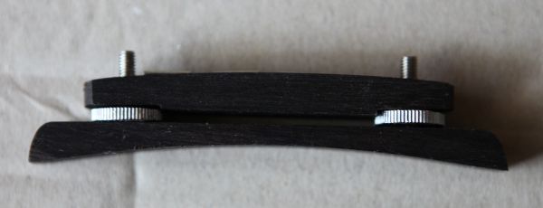

Ok. to clarify the bridge question, here's a couple of pics of the bridge (since Simon said he hadn't seen a close up)
