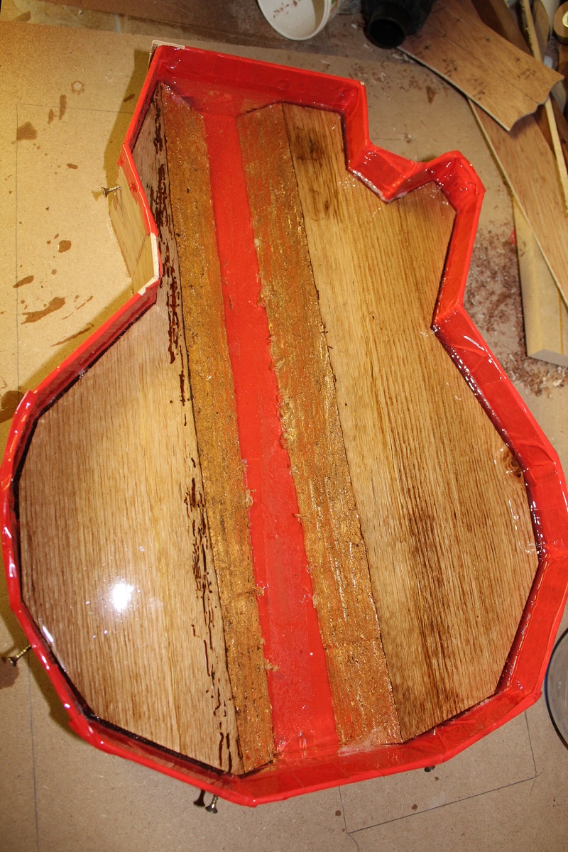

    First job was to cut the oak to rough LP shape and build a mould matching the shape as closely as possible (resin is expensive and you need to minimise wastage. The live edge of the oak was coated in resin and 24ct gold leaf applied.
    The mould is lined with plastic tape to ensure there are not any leaks and also to make it easy to separate from the guitar body
    I managed to pour it in one go but I failed to seal the oak properly first which meant I got some bubbles trapped in the river. Once cured, I drilled the bubbles out and patch filled them and they disappeared.

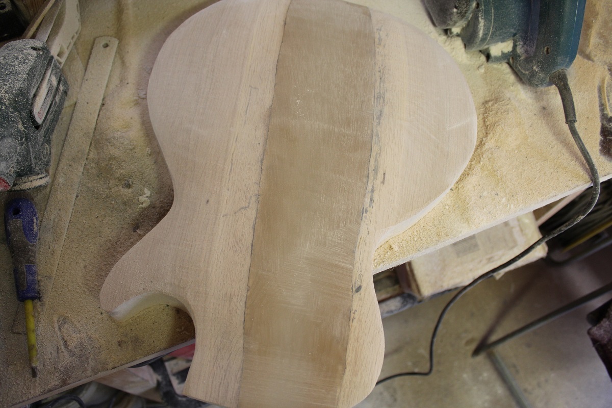

    Couple of shots of the body casting. Sorry for the quality.

Name:	River guitar first pour.jpg
ID:	37487   Click image for larger version.
Name:	River guitar body1.jpg

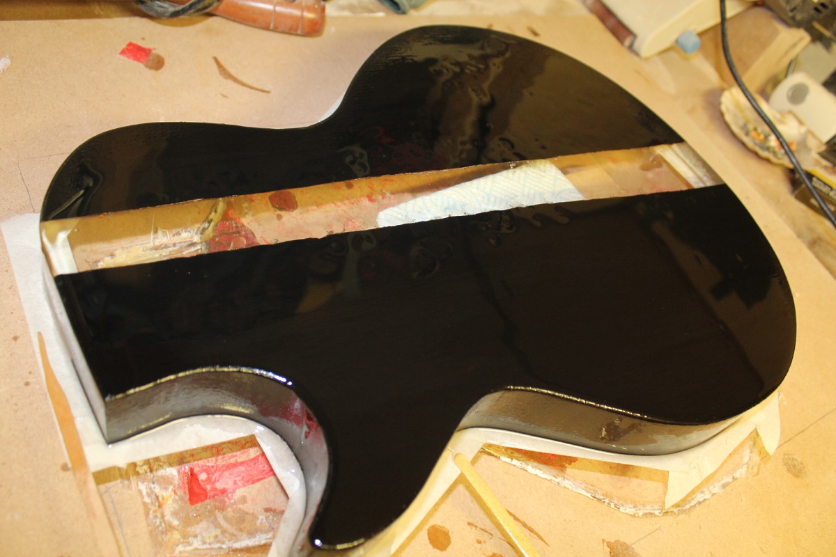

    It just so happens that I have a cup with about 3/4 inch of resin setting right now (left over from coating the back of the body - photo below).

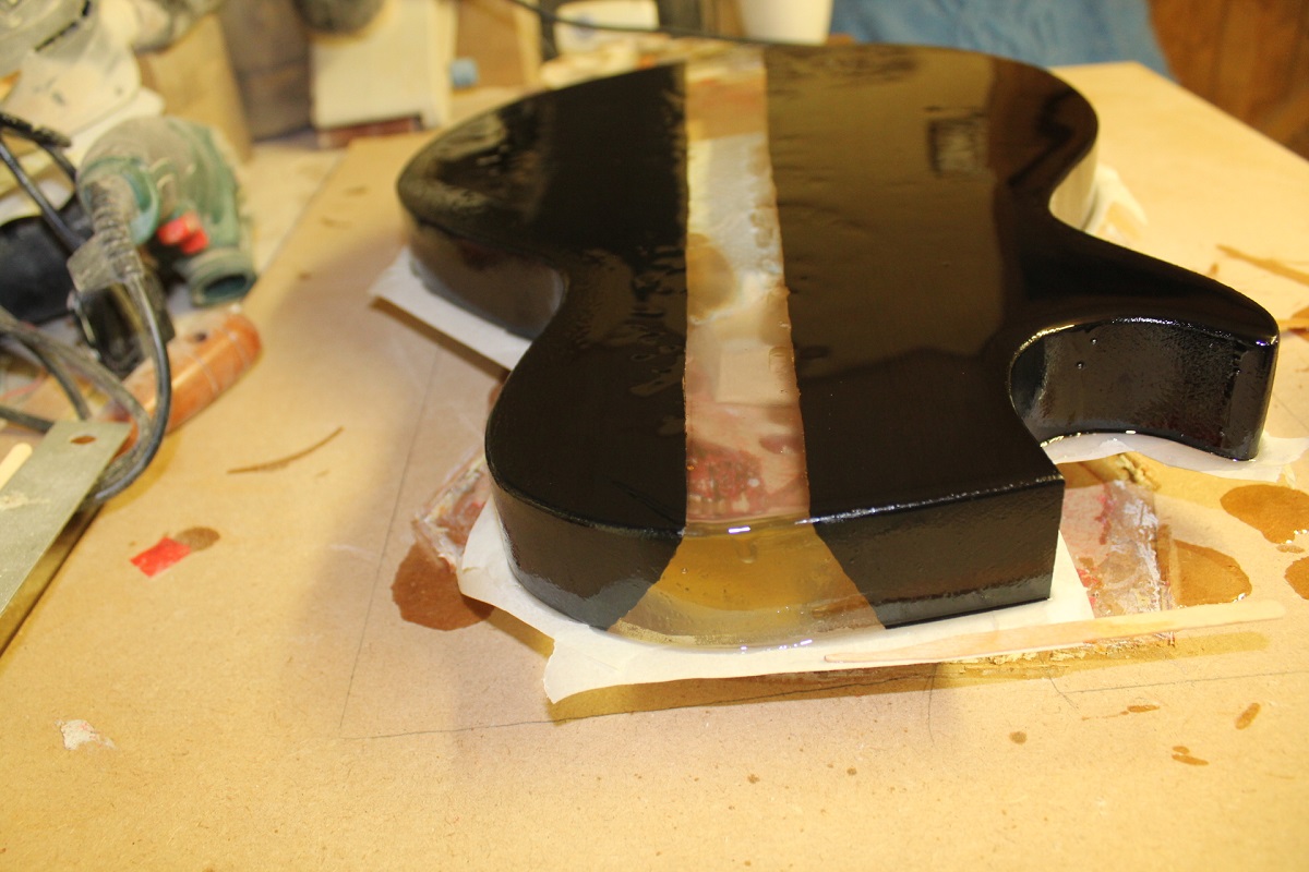

    The photos below show the back with a coat of resin applied. It shows as uneven as there is a different rate of soak into the wood.
    The dots around the horn are bubbles which require popping every hour or so for about 4 hours. It will require at lease 2 coats of resin before I turn it over and do the same to the top.

Name:	River guitar back1.jpg
ID:	37492   Click image for larger version.
Name:	River guitar back2.jpg

    At the moment I am adding the layers of resin to the body top. It is arched so just poring the resin was not an option really. Slow but I have the time,
