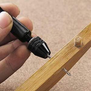

    Here’s what I did right: I used a drill bit vise and hand drilled every pilot hole by hand - no electric drill needed.
