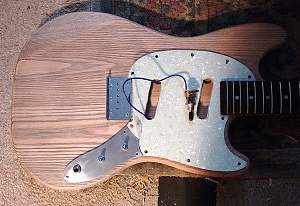

    Another day.
    Lapsed into forgetting to photograph the evidence.
    Preliminary fitting of the new scratch plate
    cheers, Mark.
  5. #55
    Update
    cheers, Mark
  6. #56
    Apr 2017
    238
    Nice pickguard Mark.
    If you don't mind me asking, where did you get the pickguard material from and what do you cut it with?
  7. #57
    Yeah this is look great!
    You can get pick guard sheets from a few places I generally use Real Parts:
    https://www.realparts.com.au/
  8. #58
    Thanks chaps.
    Quote Originally Posted by colin2121 View Post
    Colin, I get a blank sheet from here: https://www.ebay.com.au/itm/Musiclil...72.m2749.l2649
    I can usually get 2 pickguards off this sheet.
    One for this guitar and another for the Bronco bass.
    I mark it out from a used pickguard with texta, then cut it out with a jig-saw.
    I use the Ozito rotary tool to get the round edges and sandpaper stuck to a flat ruler for the straight ones.
    cheers, Mark.
    edit: I haven't done the bevelled edge yet but use a medium file to do that .
    Aim is to get all 3 ply's the same thickness all round.

  9. #59
    I hope the 2 switches show up soon so I can get some sound happening.
    cheers, Mark
