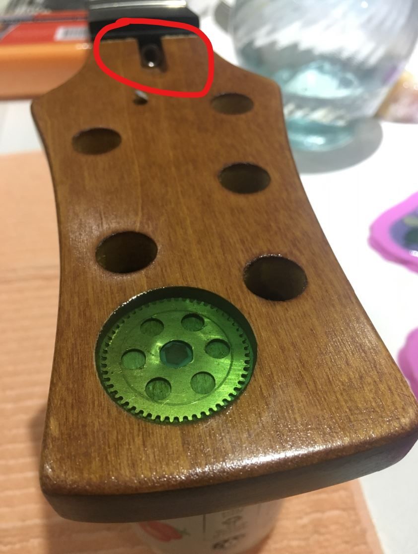

    Neck finish: I decided to embellish the head, not cut it. To do this, I firstly drilled a cavity
    And then to continue the steam punk vibe, I added more clock parts filled in with resin. Oh yes, I have also added a quartz crystal I found in Tasmania, Australia.

    You are a very talented person and have done some great work there! You've done very well with your first build.
    The 'triangular bit' will be the truss rod cover plate to cover up the truss rod hole in the headstock (circled in red below)

    Thank you Simon, that is very kind of you! It is making more and more sense. Such a lovely community
