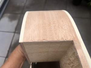

    3. Some photos of the chips would be good, so we can see how big/deep they are. I have been filling gaps with a fine household interior filler that I've mixed up with some acrylic paints (I bought a cheap set of artist acrylic paint tubes from Amazon) to match the wood colour as best I can. You'll probably have some gaps around the neck join (when the neck is glued on) that may benefit from being filled as well, so if it looks like there might be some small gaps, then it may be worth gluing the neck on, filling and then applying the finish, rather then do the body and neck separately.

    Thanks Simon. Here is photo of chips in ply near beach pocket. Any thoughts on how best to fill? I am using a colourless Dingotone finish from Pitbull. Not sure what type of finish this is, but have assumed it is oil based.
