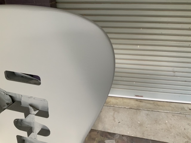

    Ok,
    Found quite a few spots where wood grain waves were noticable. So I sanded back with 100 something or other and 240 and 300 something or other sandpaper. Nearly took it all the way back so that I would have all the grain filled. Didn’t take an upside down or sideways picture for that.
    I’ve then second coated SCA Primer Filler with better results all around. Still need more attention getting one line of machining out and a couple spots of grain waves.
    Here’s some pics in random orientations.

  3. #33

    Something I have found with the SCA filler primer is that if you live in a humid place, the longer you leave it before sanding the better it is AND.... hand sanding is best, power sanding is too radical.

    Another round of primer filler producing better results. May sand back one more time and hit with one more prime filler before I start priming and painting. Still having issues with photo orientation despite taking them right side up on the phone...
    Your 100% right Cliff SCA do use a slow thinner in there paint it does take a bit longer to flash off and shrink back if you're getting a lot of shrink back use the etch 1st, if you're using a gun the 1lt 2lt tins are fine I use just about all there SCA range its good gear and cheap I like there 2lt clear I've got 1/2 a dozen tins of it and there thinners in my cub's I mix my own pearls and candy with there clear if your paying anymore for other brands your wasting money, you can get a show finish with there paint pretty easily if you go to there Holden hill store and there out of paint is because I purchased all of it lol I can have 5 guitars on the go at a time

    Do you use the etch on timber?
    Yep its a pretty good sealer
