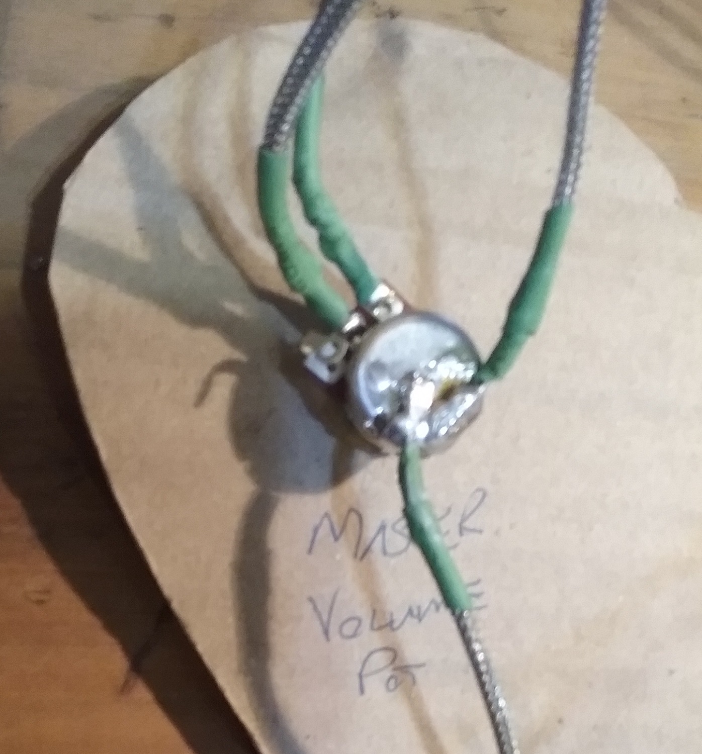

    "Blue Heeler" Bondi Blue GR-SF1: Pt12 Re-doing the Whole Circuit
    Quote Originally Posted by Honkenstein View Post
    Not happy with my wiring ... I've also purchased some 10 ft of ("vintage") shield braided wire. Yes, I'm re-doing all my circuit work.
    Yikes! Needed to spend AUD ~$35 on a set of snips that would handle the s/s shield braid. Nice, clean cuts ... but most of the time you want to only go through the outer (s/s) braid, not the two cloth braided layers, so chomping half-way through sometimes didn't work. A classic hobby knife facilitated cutting the cloth braid away fairly cleanly most times.
    After completing the circuit I tested it in an amp and positioned the pickups in proximity of another guitar's strings. IT DIDN'T WORK!!! No sound at all, for pity's sake. No-oooooo! Looked at the circuit diagram and my soldering ... all looked good! ... except it seemed like one or both of the treble bleed components got pushed back and shorted against the pot body. Bent it/them back into the clear. Tried the amp trick again and got a small modicum of sound.
    There's no way I was going to go through a third complete re-wire, so if it didn't work when I installed it, then so be it! (sigh of resignation) So I installed it into the body, then set the neck with glue.
    I'd used all of my 10 feet of the wire of the GR-1SF kit. None left. Small amount of waste. Enough "slack" in the circuit to not stress joints when installed in the body. Used rubber exercise tubing to get the components through their holes.
    I think my soldering is pretty decent for an amateur!
ID:	34646Click image for larger version.
ID:	34647Click image for larger version.
ID:	34648Click image for larger version.
ID:	34649Click image for larger version.
