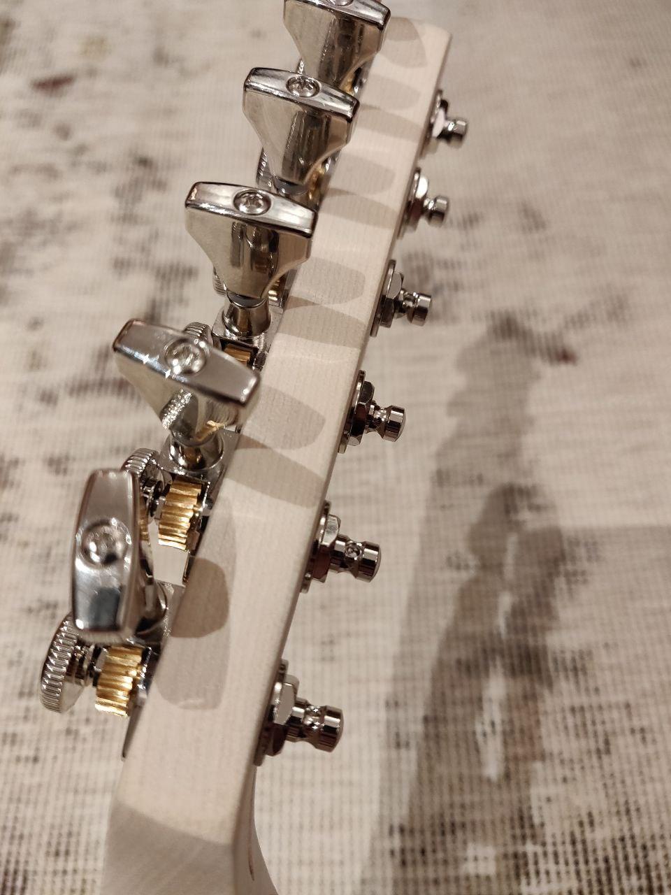

    Back in the UK to find that the Hipshot tuners have arrived. Test fit:
    As expected, the screw holes don't line up with the factory-drilled ones:
    ...so tomorrow I'll drill two holes the same size in the headstock offcut and plug one with a toothpick and fill another with light wood filler, and see which is least conspicuous when some of my finish is put on top.
    It might be hard to see here, but the top two tuners in this (staggered) set have the string hole (technical term) only just accessible:
    Are PBG headstocks unusually thick? Shouldn't matter, anyway, as the tuners are locking ones so there's no need for multiple turns around the peg. And anyway it's the thin top two strings.
    Anyway, I love the way the open gears look.
  4. #94
    Genuine strats & teles are in the range of about 15mm.
    If the headstock is thicker than 15mm and it's an issue for you, either practically or aesthetically, it wouldn't take much with an electric sander to thin it. Work 80-120 grit down to 240.
    Now would be the time before you get any finish on there. (which is going to make it marginally thicker again)
  5. #95
    As long as you can fit the string through the hole, you'll be OK. You want the B and E string holes to be as low as practically possible so you don't need to use string trees.
    I fitted some of the Hipshots (enclosed versions) to a friend's Fret King, where the original height-adjustable Gotohs just weren't locking properly. I used the backing pieces and that covered up the holes without needing to do any filling-in.
  6. #96
    Jan 2020
    London, UK
    116
    Headstock is between 14.7 and 14.9mm thick according to my shiny new digital caliper (can't remember who recommended getting one, but it's an excellent toy :-) so it looks like all is well.

  8. #98
    I LOVE those tuners man. Yeah clearance is fine since the locking tuners don't require wire wraps around the post.
  9. #99
    Jan 2020
    London, UK
    116
    Yup, when I saw the design I almost bought them on the looks alone, but the reviews were great and now that they've arrived I can say that they seem very well put together -- very solid feeling. Looking forward to trying them out
