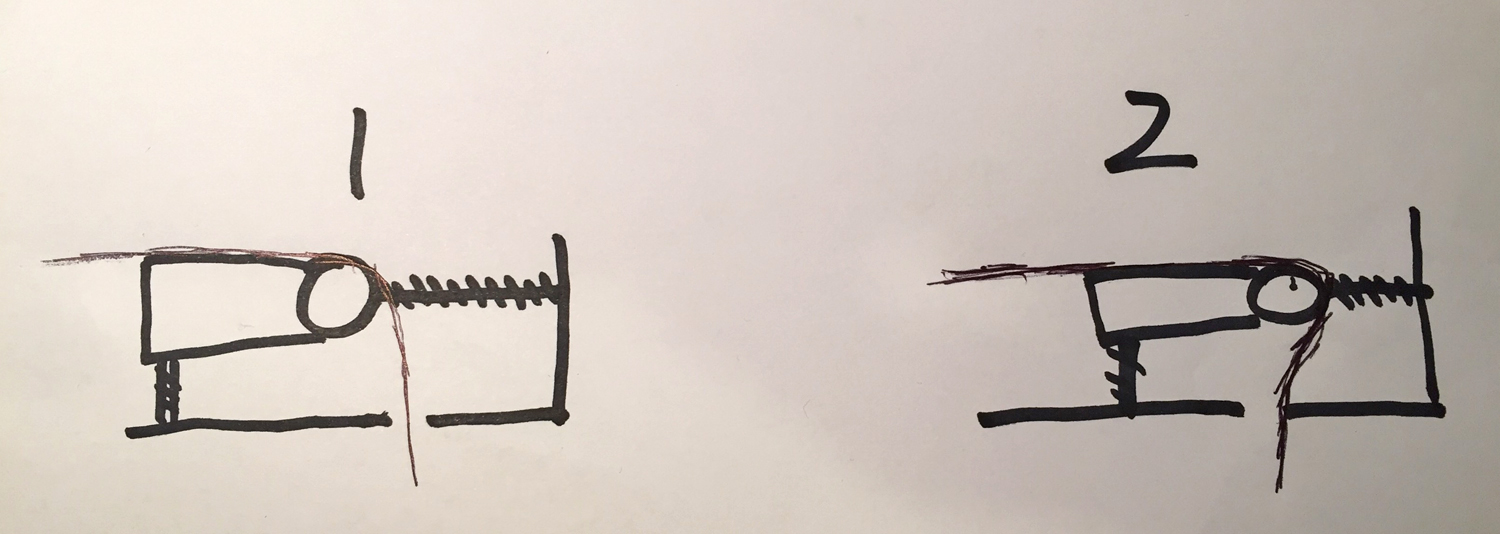

    Possibly the edge of the hole where the strings appear out of the block? The graphite block is on the top of the saddle, but the string also wraps around what appears to be a round bar at the back of the saddle, so there's some extra friction there. If the saddles are too far back, then the string is being pulled back before it can bend forward again.
    Difficult to tell exactly where on the guitar bridge the string breaks are occurring without being there. Some people do report a lot of string breaks with it. As the saddles don't move (just the trem block), there's a lot more friction than with a normal Strat trem bridge.

  6. #16
    So are the strings running more like 1 or 2? 1 is better for lower friction.

    Hi Simon.
    The strings are more like '1'.
    Here's a side shot of the E 6 string.

    Ah, that's OK then. Not sure at all now. Just try some new strings.
