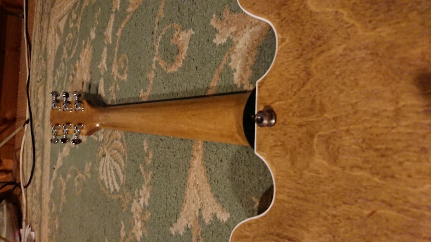

    Full Length
    Hi Simon,
    Thanks for the comments.
    Never used locking tuners before and when fitting the string I didn't really see the advantage over 'normal' tuners but when you explain it like you did I can see the point. I'm not a string breaker and even the G string tuning has been really stable with a new set of string on and playing a lot of bending to try and find if there are any dull spots on the frets. None found.
    Was going to take a few better photos tonight or tomorrow as I had too many out of focus ones last night. Once I have the photos i'm happy with i'll post in the gallery and send it in for February GOTM. Here are a couple of 'soft focus' shots lol
ID:	33151   Click image for larger version.
