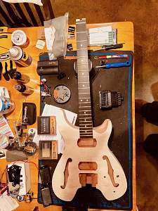

    I've been working on guitars for friends, family and coworkers for more than 10 years. I figured it was about time to bite the bullet and go a little deeper into the weeds.
    I love the look of this guitar. The quilted maple top has a few flaws in it - one sizable one, in fact - but I'm going to use it as a means of learning how to work with them.
    I'm going try a sunset glow finish on this. Heavy on the orange with lemon yellow highlights.
    Stay tuned!

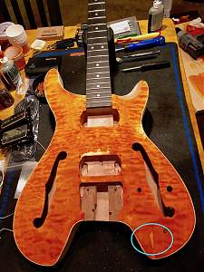

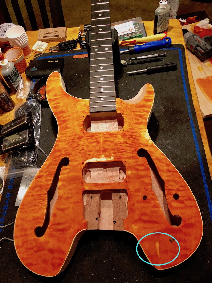

    I decided on, what I'm calling, a citrus glow finish. The first two coats are on, and I think it looks good! One layer of diluted orange, and diluted lemon yellow.
    I've circled a blemish in the top. Is that normal, or did I get a second?
    R~
  9. #6
    That looks like a glue spot.
    Goof off usually gets rid of them but that would also mean re-staining that section too.

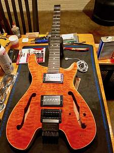

    Thanks so much for all the advice on the glue spot. Denatured alcohol and light touch with a small wire brush did the trick. I'm ready for a final sand of the back and sides and some clear coat.
    I'm really pretty over the moon with the way the top came out. It's been a labor of love for more than two weeks!
    I think I made the right choice with the ebony neck. It looks fantastic with the black hardware.
    Cheers!
