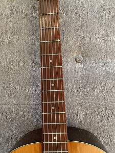

    Hi Friends
    Nice to see other S-50A owners discuss this nice guitar.
    I also own this model. Bought it in Italy in 2004 in very good condition, and it was sitting quietly in storage till corona came and motivated me to start learning guitar.
    Based on the photos you posted, my guitar looks identical, so it was interesting to learn new information about it.
    Since I’m new to guitars and music playing, I wanted to know if you found this guitar to be laminate or solid?
    I tried to follow YouTube instructions on how to distinguish between the two build types, but I’m still not sure if my observation is correct.
    Hope someone can clear the fog

    I found this thread while searching for some info on my Yamaha S-50A, which I bought 2nd hand in the late 1970s.
    Even though the thread a little old, I thought it be best to clarify the top - it's a laminate - not a solid top. The grain is interrupted around the sound-hole where the laminates meet. There is no truss rod.
    That said it holds tune well and plays well. Being a ply top the sound is OK but not "beautiful".
    The content of the thread confirms what I was led to believe about it way back when - basically a nylon classical guitar design, though with a narrower neck, supplied with steel strings and a different model number. Maybe the bracing is different - I wouldn't know. - My guitar has a few wear and tear marks - and the first and second frets show indentation wear on the 2nd and 3rd strings.
