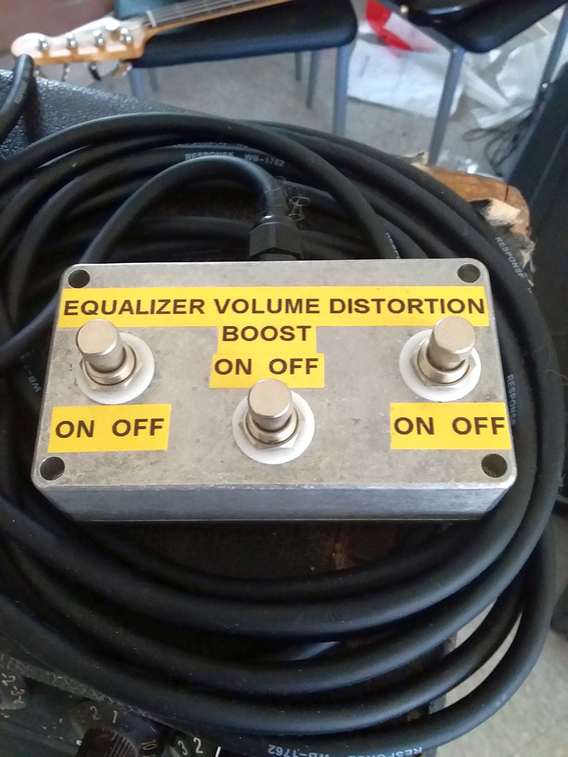

    Here's a pic of the footswitch I made for my Fender Super Twin amp, the one I'll be making for the Renown is going to be along the same lines, but I'm going to see if I can incorporate some status leds, a green one, a red one, and a blue one, haven't decided which colours I'm going to use for each function though:

    5,513
    Update:
    So I've finished getting together all the needed bits and pieces for making the new footswitch for my Peavey Renown amp, I'm going to be doing some studying of the schematics so I can understand how the footswitching works, with these things it is always a good thing to take your time rather than rush it, there's a better likelyhood that it'll work first time.
    Here's a list of the bits and pieces I got together for making the new footswitch:
    X 1 Diecast Aluminium case.
    X 1 Pack of adhesive Rubber Feet.
    X 1 Pack of 25 M3 X 10mm screws.
    X 1 Pack of 25 M3 nuts.
    X 1 Pack of Hookup Wire in assorted colours.
    X 3 7-Pin DIN Plugs (two spare ones just in case I make a stuff-up).
    X 3 Panel-Mount DIN sockets that accept the DIN Plugs (again two spare ones in case I make a stuff-up).
    X 1 Red 3mm Led with chrome bezel.
    X 1 Green 3mm Led with chrome bezel.
    X 1 Blue 3mm Led with chrome bezel.
    X 5m of Grey 9-core round computer cable.
    X 1 Pack of black cable glands.
    X 1 Roll of 3mm Goot Solder Wick.
    X 3 Metal 3PDT Footswitches.
    X 1 Pack of 300 1% Metal Film Resistors.
    And...I think that pretty much covers it.
    5,513
    Update:
    Okay, so I decided to do some work on the Peavey Renown amp chassis today, this involves removing the original DIN Footswitch and replacing it with a new one that accepts the metal 8-pin DIN plugs I bought from Jaycar, all I had to do to remove the stock DIN socket from the chassis, was to undo two small mounting bolts and clip two cable ties, and then disconnect a plug from the circuit board, that's actually a good thing since it makes it easier to solder the new DIN socket to the wires going to the plug I removed from the circuit board, I then made a rough drawing of how the wires were soldered to the stock DIN socket, and then I worked out what pins to solder the wires to on the new DIN socket, which turned out to be not that much different to the stock DIN socket, but it did leave me with three spare solder lugs on the new socket which I could use to provide power for the three indicator leds in the Footswich....cool!!!
