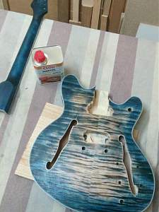

    I ve cut the headstock to a strat style and considering to use a gibson standard humbucker set i use to have.
    I used Clou water based stains for coloring. Now i m in the fifth coat of clou oil (hartol) which hopefully its close to true oil which is not available in greece and its really difficult to find similar products in the market. Considering applying two or three more coats of oil and then ready to start setting things up..

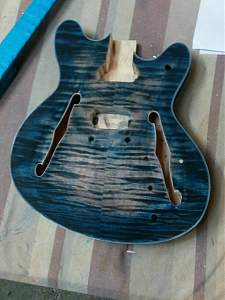

ID:	28416 final sanding

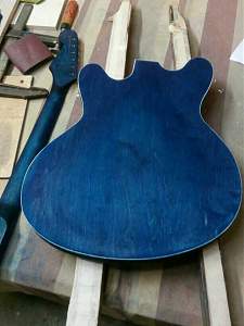

ID:	28417 backside still in progress

ID:	28418 hartol by clou (not tru oil but i think it works

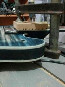

ID:	28420 gluing the neck

    I m quite disappointed because i stained the binding and i thought that with a scraper i could remove the stain completely from there , but unfortunatelly a messy blue coloring there is now on bibding. If i had to do a clear coat on that guitar I wouldn t be happy at all. Now that i have this semi-satin finish with the distressed blue i m not that worried because it kind mathes the slightly distresses look.
    Its my first build and i didnt want to spent much time on it and in details by thinking any possible failure and be as carefull i could get. Its an experiment to see how things works
