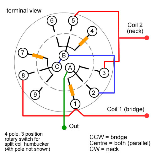

    If you want to keep the MM 4 X control knob look, using a rotary switch with the same knob as the pots is the go. I used a 4-pole / 3 position to achieve the individual coils/parallel switching config as the EB era Stingrays do with a blade switch. I prefer this to the blend pot as there is more signal in the parallel position, and I found blends (other than full parallel) did not offer much tone variation.
    Another little trick with the Belcat EQ-B2T preamp is that the bass boost/cut can be excessive, with a limited useful range of the pot. I "corrected" this by changing a few components around to get the travel of the pot to provide the best tonal variation. Hope this helps.

    Unfortunately RalphH, that switch wiring won't work as-is with Waz's pickup as it's only 3-wire. The pickup coils are internally wired in series, with the 'third' wire connected to the centre connections between the two coils. So it can be tapped but cant be connected in parallel unless Waz takes the pickup apart and manages to wire it as a 4-wire pickup so there's fully independent access to both coils.
