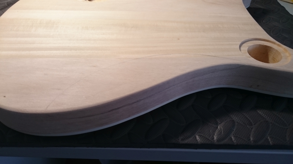

    I would like to show the progress. I filled up and re-drilled stoptail holes, because they were too loos for the Schaller bushings. Maybe I will have to do the same with bridge bushings drills. I will see when the Schaller bridge arrives.
    The belly carve is finished, and I am happy with it. I think it is not bad for the first time I work with wood. Initially I wanted to do a cutaway carving, like most PRS have:
    http://www.12fret.com/wp-content/gal...-cutaway-1.jpg
    Now that I see the difficulty, maybe I don't do it. It's difficult to get a perfectly round cut, and there's also the binding. Probably I would make a mess!
    I am still working in the fret levelling.
