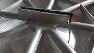

    The second issue, I assume I'll have to drill a hole through the spider to allow the piezo wire to pass through?
    When the piezo sits in the bridge recess I think the wire would have to be bent to an unacceptable level. A hole would allow a less strained cable on it's way to the control cavity.
