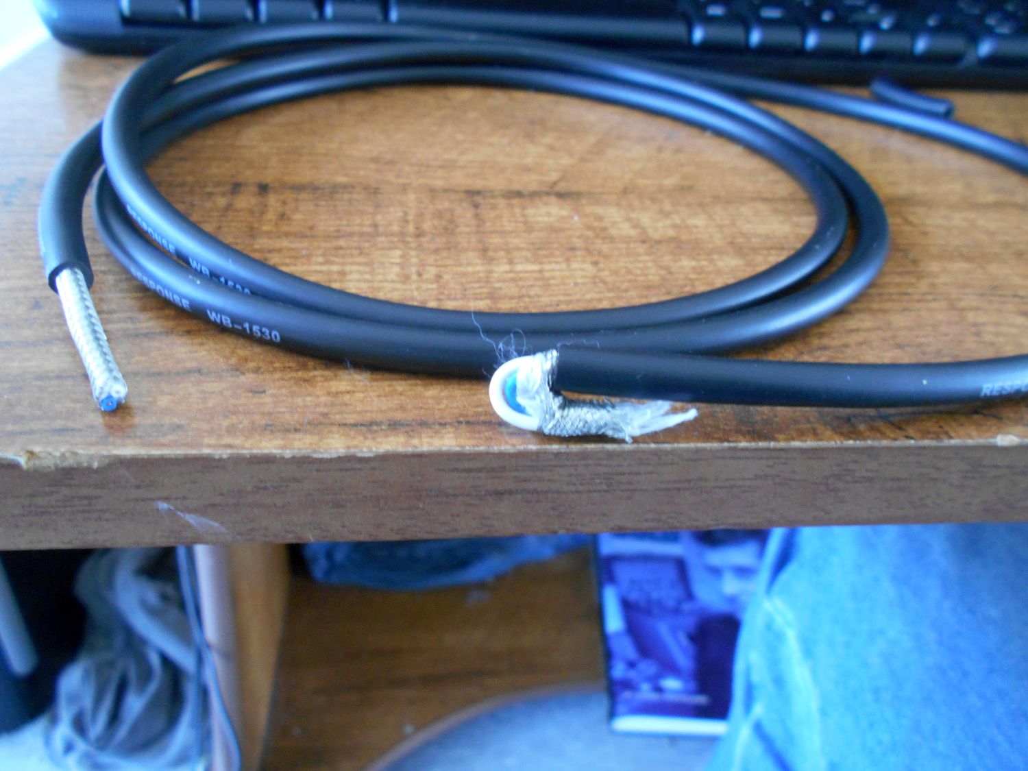

    First thing I do is decide how long I'm going to make the instrument lead, I tend to go by the rule of thumb that states that it is always easier to shorten a piece of wire than to lengthen it, so, I always try to make it a bit longer than I really need it to be, although sometimes I have to work with whatever piece of cable is available, in this case I've got two pieces of Jaycar WB-1530 cable that I'm going to be using to make two leads, they are not that long, about a couple of metres or so, it doesn't really matter cause I can use them as patch leads for my pedals, the only proviso is that they work perfectly when finished.
    Since the cable is already cut to length, the next thing to do is to strip the black plastic insulation off each of the ends of the cable so that I can solder the plugs onto the inner conductors and shielding braid, solder doesn't really take very well to the plastic, as I go through the process of making the lead I'll post pics so you can see what it should look like for each of the steps.
    Here's a pic of the Jaycar WB-1530 cable I'm using with the insulation on both ends stripped off to about 20mm:

    After doing that to both ends of the cable, I pushed the braid back against the remaining insulation so that it loosely bunched-up:
Name:	Braid Pushed Back_resized.jpg

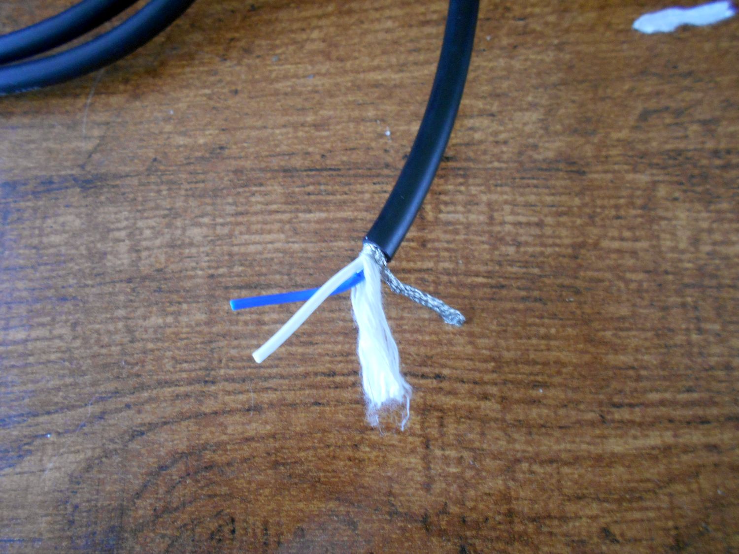

    The next thing I did was to use the tip of one of my multimeter probes to make an opening in the braid so that I could pull the inner cores through it:
Name:	Hole Made In Braid_resized.jpg
    After making the hole in the braid, I carefully pulled the two inner cores and the white cotton fibers through it:
Name:	Cores Pulled Through_resized.jpg
    After pulling the two inner cores and the white cotton fibers through the hole i made in the braiding, this is what I was left with:
Name:	Cores And Braid Separated_resized.jpg
    I did the same to the other end of the cabling to complete the preparation of the cable prior to soldering on the plugs.

    For those wondering why the Cotton is there and why that we just cut it off flush - The Cotton is just filler to help the overall cable maintain its circular shape. It also helps in minimising scuffing of the centre wires when the cable is flexed during use. In the connector it serves nil purpose so can safely be removed.
