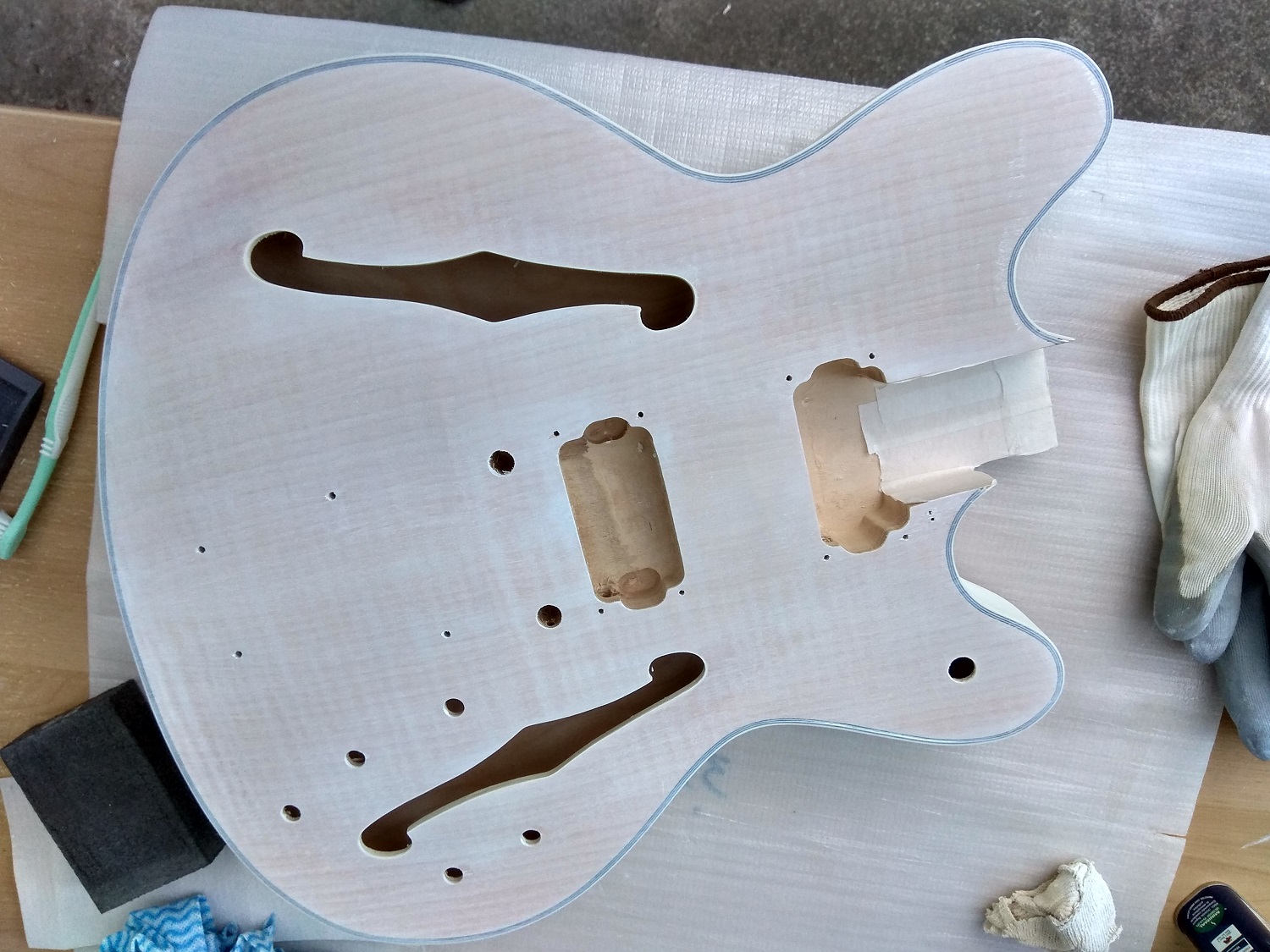

    Hey guys, need a lil help here. Was trying to even out the coat of white dye on this FS-1 kit when noticed that there's two large spots near the upper bout where the dye just doesn't stick to after a while. Might need to adjust your screen contrast to see it as picture turned out too white. Think I may have accidentally 'burnished' those parts trying to get the dye in.
    How can I fix this? Appreciate the help, it's my first kit attempt!

    I can't see anything, but i believe you.
    The two main reasons why a dye wont take is because of a glue spot or because the grain of the timber has been sanded with too high a grit of sandpaper thereby "polishing" the wood and not leaving enough "tooth" for the dye to hang on. Both have a different way of "fixing" the issue
    which of those culplits do you think it is?
    What grit/grade did you sand up to and what is the dye/finish you're using?
    They don't look like glue spots to me - too big and in the wrong place for that. I'd suggest it's the 'too high a grit' polish cause. The answer is to carefully go over those areas with a coarser grit, say 220. That should rough the wood up enough for the stain to take.
    Well I've only sanded up to 240 so was pretty bummed about not knowing what happened. Decided to do a very light sanding again with 240 just to rough up the surface, and reviewed some woodworking videos on using wood dyes.
    I think I have used the wrong method of trying to rub-on the dye in small amounts at a time instead of flooding/wipe-off resulting in a really blotchy and uneven outcome.
    Also ran a damp(er) rag before applying the dye which I learned helps water-based colours (Liberon Palette Dye) to go on more evenly. Turning out better.

    Looking a lot better. Doing it in patches will leave tide marks along the joins where you overlap, and you naturally get two lots of dye deposited. All-in-one is the better way.
    You managed to sort it yourself, which is good. You'll find that there is very little that you can't recover from and get a great final result.
