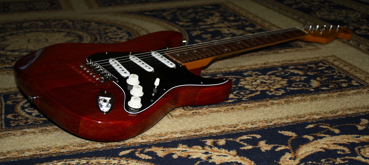

    A bit of inspiration....
ID:	24176Click image for larger version.

    What bridge came with the kit?
    Pedalboard Build
    Member Mr.Drifter's Avatar
    Oct 2017
    Western Australia
    99
    Time for a hardtail bridge, and to make a hardtail ;D
    Quote Originally Posted by churchie View Post
    Looks like a trem sitting on top of the body Churchie
    Aug 2017
    Melbourne, Australia
    165
    Could get a Tune-o-matic bridge, and make a T-O-M strat......
    I've always been intrigued about things like that
    Pedalboard Build
    5,666
    Go Avant garde and add a traditional archtop bridge and a trapeze tail piece!
    FrankenLab
    Hardtail it! Adding a tune o matic or archtop bridge will require either to angle the neck pocket or recess the bridge.
