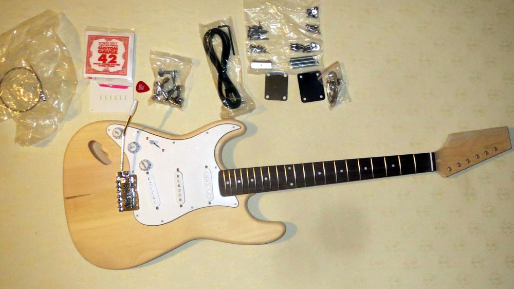

    OK, I've been able to make some headway at last!
    The mock build went satisfactorily:

    This is what I've done thus far.

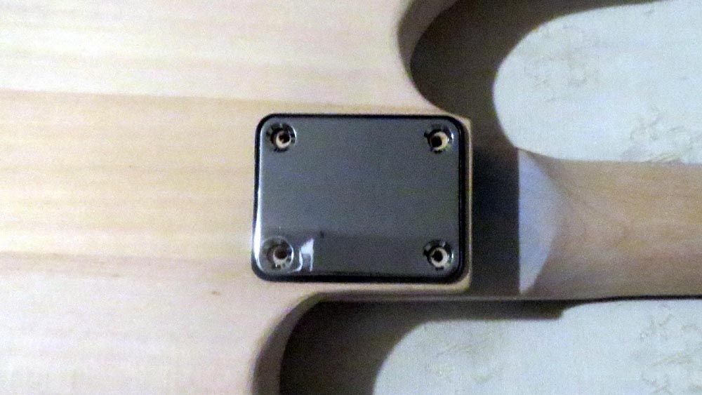

    The first thing was to fit the neck which requires drilling some pilot holes through the holes already drilled in the body. Pitbull's drilling skills don't seem to have improved, so I had to basically fit all 4 screws at once to get the backing plate as centered as I could.

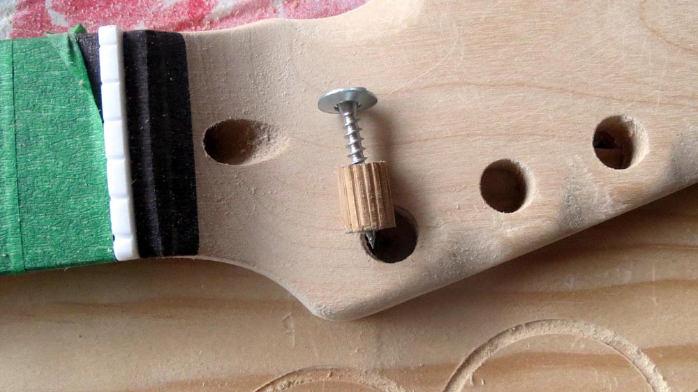

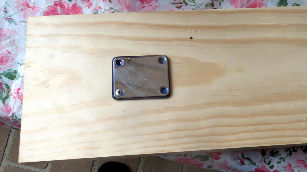

    For doing the fret levelling and headstock shaping, I decided it would be a lot easier to mount the neck on a plain pine board. I drilled one hole to allow one of the neck mounting screws to be screwed into one of the screw holes just drilled into the neck....
    ...and then I drilled a hole through the centre of a short plug of 9mm dowel and placed that in one of the machine head holes. That allows me to move the neck around to access different parts of the headstock while at the same time screwing it firmly in position:

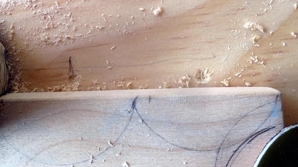

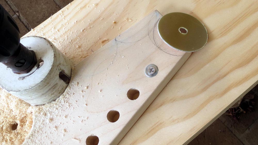

    My first step was to re-shape the headstock into the "platypus claw" shape I mentioned earlier.
    I made the scalloped cutouts with a 50mm (2") hole saw. First I cut out a circle of plastic to use as a template, and then used that to mark the circular shapes with a pencil.
    Once that was done, it was a simple matter to use the pencil marks as a guide to marking the holesaw's centre bit position.

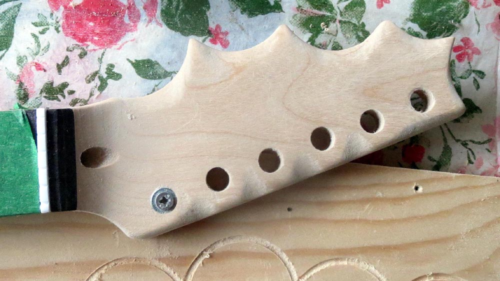

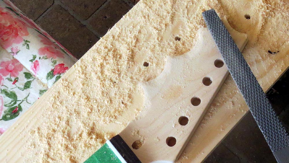

    The next step was to smooth the cutouts to a more "organic" shape. This is easily done with a cheap wood rasp, and although it might initially look rough as guts...

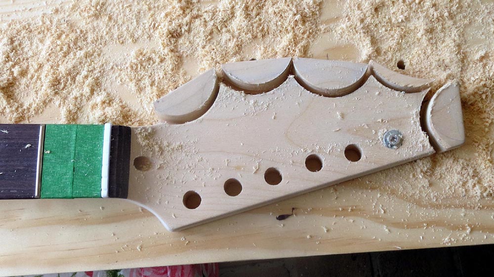

    ...it can be sanded smooth in no time. I bought a cheap packet of assorted sandpaper and started with 60 grit, working my way down to 250 grit.
    I did the flutes on the other side the same way.
