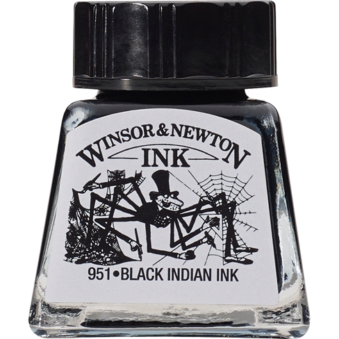

    You could use Winsor & Newton Indian INK to dye the fret board, they have several types, you want the one with the spider on the bottle, it contains Shellac, which dries hard, and is also used as a guitar finish in it's own right.
Name:	W&N spider I-ink.jpg
    I've dyed my ES-3 kit's fret board with it.[I've also removed all the frets and block inlay so I can put real MOP inlays in instead, but that's getting beyond the scope of this thread]
    You could lightly dull the finish with fine steel wool on some frets, and buff the ones you want shiny.
    It might take a few applications to get enough of the ink to impregnate into the fretboard, to do what you want to do [getting some frets dull without removing to much will be the difficult thing, but not un-doable]
    In any case, it's just a matter of keeping on applying enough Ink till you get the effect that you want, you don't really need much for a single coating, so a single small bottle should be more than enough to get the job done.
    Eventually the shellac will wear through with playing, all you need do is apply some more over the top to get it back to the way you want it.
    IMHO using epoxy over some frets and not over the others [shiny/dull] will firstly give the fretboard a weird sort of inconsistent feel to it, and secondly might cause the fretboard to do some weird thing regarding keeping the frets in, this is just hypothetical, but I'm basing this on the fact that the frets that arn't sealed with epoxy will still allow moisture to get into the wood, so your going to a get a neck with varying amounts of moisture running down the neck, which might over time be the cause of some frets wanting to pop.

    Thanks for the info Tweaky. I'll have a look at this. Only problem could be that I'm in The Netherlands so chances are few to get this brand of ink somewhere around here in Europe. But I won't give up on my idea and perhaps I can find some replacement ink.

    Can be bought in the UK Kick so would have thought you can get in the Netherlands...

    Just go to any Artist supply store and they will have it, it's one of the most popular brands in the world.
    It's used by anybody that is into calligraphy, and comes in shades of Brown, Blue,Green etc.
