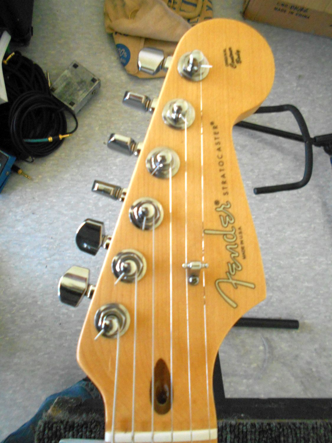

    Update:
    New set of Fender Locking Tuners arrived in the post today, I bought them on eBay last fortnight, anyway, they are a drop-in replacement for the Fender Standard Tuners as installed on most Fender guitars made in Mexico and in America, the standard tuners feature two small studs that fit into small holes drilled near the mounting hole on the back of the headstock, the two studs prevent the tuner from moving under string tension so that no mounting screw is needed, Fender Locking tuners the same two studs as well.
    I removed the stock Fender Tuners from the headstock of my Fender USA Strat and replaced them all with the new Fender Locking Tuners, and yes indeed, they are a direct drop-in replacement for the stock tuners, requiring practically no mods to the guitar whatsoever in order to install them, they do seem to be helping to keep the guitar in tune better which is good, so I'm happy with them.
    Because they are Locking Tuners you don't need to have much of the string winding around the tuner-shaft, you just pull the string taut and tighten the thumbscrew on the back of the tuner and then cut off the excess string and you're done, it then doesn't take much winding to tune each string up to pitch, and best of all, from the front of the headstock, the tuners look completely stock, I'll post a few pics of the new Fender Locking Tuners installed on my Fender USA Strat shortly.
    Here we go:
Name:	Fender Lockers 1_resized.jpg
Name:	Fender Lockers 2_resized.jpg
Name:	Fender Lockers 3_resized.jpg
    This is a very easily reversible mod to do to a Fender USA, or Fender Mexican Strat.

    Locking tuners are great - everything I've rebuilt/modded has them installed!
    Is it an optical illusion or are those staggered string posts, doc? They certainly look plush!!

    It's definitely not an optical illusion, those are staggered-height posts, apparently the idea with that is to eliminate the need for a string tree.
    I like how Locking Tuners dramatically speed up the process of re-stringing your guitar since you don't need to wind much of the string around the post to bring the string up to pitch.
