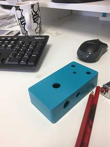

    Drilled and polished the enclosure at work.

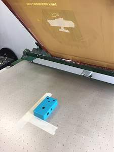

    Primed, sprayed and screen printed the enclosure at work too...

    Looks cool, do you clearcoat the pedal enclosures after they're screen printed?
    Yeah, I think if I didn't then the text would chip off for sure. I'm just using White Knight acrylic (satin for the preamp I made, and gloss for this one). Will have to wait and see how they hold up with use.

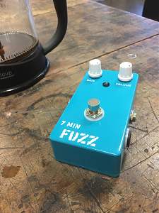

    And, it's done!
    I managed to lose the fuzz when I wired it into the box, so I'm assuming I've just got a poorly soldered connection somewhere. Will look more closely tomorrow. The bypass and the LED both work, so that's a start. Also I didn't include a battery option, just the DC jack.
    Also, the colour is much more turquoise in real life. I'm pretty happy with it.
