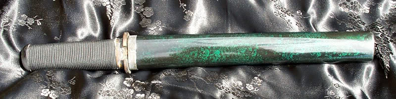

    the clear on this is rattle can enamel over dabbed on auto acrylic on a rattle can black base
