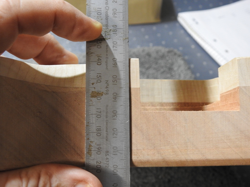

    Body
    Two piece body is really well joined no stray glue and the timber was finished well. Really only requires finish sanding to get to the point where you are looking at applying stains /finish
    The two piece cap is well joined and again no stray glue. The figure on the cap is nicer that what comes up in the photos and will finish well. Finished well and is smooth without the grain cavities normally associated with veneer tops.
    Body thickness 45mm with the cap at 17mm through the centre. Thickness of cap at edge is 5mm.
    Post holes for tailpiece and bridge are drilled at the larger dimensions that suit the Chinese hardware.
