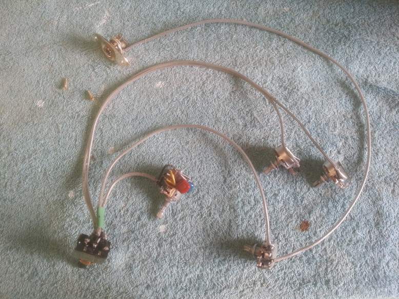

    Sheilded cotton Push back Braided Wire for Hollow bodies
    I bought a 25 foot roll of the stuff from StewMac's. you can get it on FleaBay and a few other places.
    The stuff on Fleacebay is way over priced.
    Your hollow body loom should look a bit like this . I used an enclosed 3-Way switch but you can just as easily use the open Gibbo styled ones.
    My Setup is 1 Tone, 2 Pick up Vols and 1 Master Vol pot.
    The tone pot I used an A500k push pull pot to switch from a .023uf Cap toa .068uf caps. The Vol pots are also A500k.
    I've done these using .023 & .047uf caps. but the amount of discernable tone change is bugger all.
    Cheers PK

    One more item on this.
    If you are using a tailpiece then drill a small hole in the middle of the mounting place for the tailpiece, then run an earth wire from here. this substitutes for grounding the bridge.
