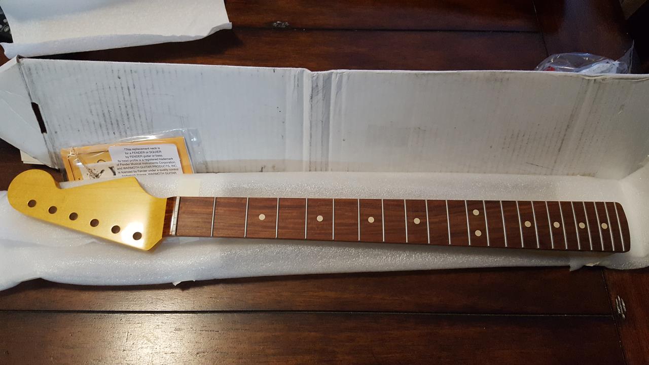

    Earlier this year in a fit of impulsive online shopping I started to gather the parts for a strat build loosely inspired by Eric Clapton's Brownie and Stevie Ray Vaughan's Number One.
    • alder body with 3 colour sunburt finish
    • maple neck with pau ferro fretboard
    • B/W/B pickguard with ivory knobs and pickup covers
    • GFS Trucoil Vintage pickups
    • chrome hardware
    • Fender mid-boost/TBX electronics kit

    It will hopefully be done this week so I thought I would throw up a thread for it.
