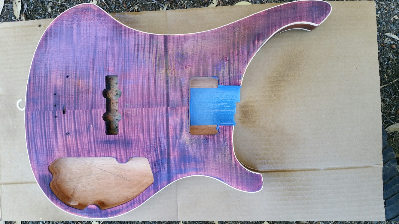

    Looks like you have sanded off a lot of colour or is that just how the photos came out?

    That's correct Waz...
    Sanded until the Maple is just starting to break the surface. It is losing the burst effect but the contrast of rawish Maple against the dyed Maple is really making the flame pop and I like it.
    The Poly in the Maple is making it very slow going so I have little fear of sanding right through to the Mahogany underneath...
    Looking now at the photos on the computer screen I'm starting to have thoughts of dying the exposed Maple a different colour such as Yellow or Red.... Maybe I should have a few more beers to quell my excitement...lol

    The photo doesn't do it justice...
    I hit it with some Red stain knowing full well I'd get a Pink..... but Pink and Purple do go well together...
    Just hoping the guard and hardware hide, disguise or distract from most of the blemishes...

    Interesting effect. Would tend to think a diluted wash of the original stain would help pull it all together.

    As I said earlier Waz, the photo is misleading...
    In full daylight it doesn't look so dark. And with a wash of the original colour, even a light one, the flame of the Maple would disappear into a deepest of Purpleness. The Pink at least gives the flame something to contrast against. It is just sad that the flame isn't more even across the entire body. Before I had patches of nil flame with patches of Purple dye, now I just have patches of nil flame (which the photo does highlight).... No it isn't sand through...
    There are a few spots of what looks like Blue/Purple which is where the original dye soaked into the Maple really well and were impossible to sand out without high risk of sanding through, so I decided I'd live with them. Most will be covered by the guard or the bridge, but some of the smaller ones will be visible which I suspect will bring a little dynamic character to the overall look. In some ways the nil flame patches could be mistaken for some kind of wear marks ...
    That veneer issue is really annoying. I went for Basswood but that isn't brilliant. A few QC problems and areas I wasn't able to sand out due to depth and binding

    Nail on the head Stuzl...
    Where I have flame it is a real nice flame ... Sad that 1/. the veneer joint is not on the centre line, and 2/. the flame isn't bookmatched very well...
    Such is the life of kit guitars.
    I suppose if I wanted I could replace the veneer with one of my own from http://www.veneersupplies.com/catego...neer__H__-__M/
