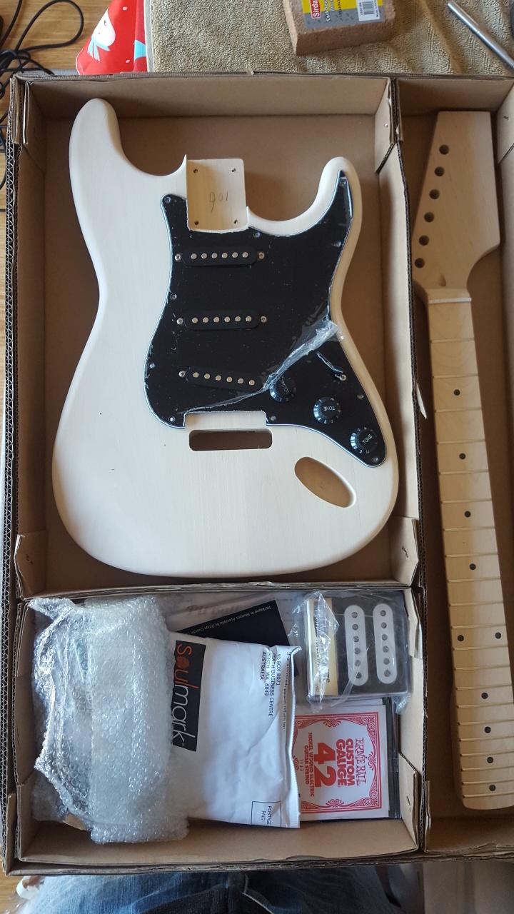

    it has arrived! im like a little boy at Christmas once again. haha
    do these guitars come already wired up?
    is there a trick to line up the bridge?

    5,666
    Hi Brokin, the ST is intended to be an easy starter kit, so a lot of the wiring is presoldered, i think you only need connect earths and jack points. I see you've order PUP upgrades, so you'll need to refer the wiring diagram and sub in the upgrades for the kit ones.
    I really like the blacked out Scratchplate look BTW.
    FrankenLab
    Hey Brokin nice looking kit. Yes there are only 3 solder joins on this kit, earth wire to the tremelo spring claw and hot and earth wire to the jack.
    Lining up the bridge is easy, put both E strings on, clamp the neck and drill the bridge screw holes so the string to edge of fingerboard offsets are about the same
    2,799
    Nice choices there but as I have noted elsewhere the kit pup covers won't fit the Toneriders because of the spacing of the pole pieces but there are heaps on fleabay for very little.
