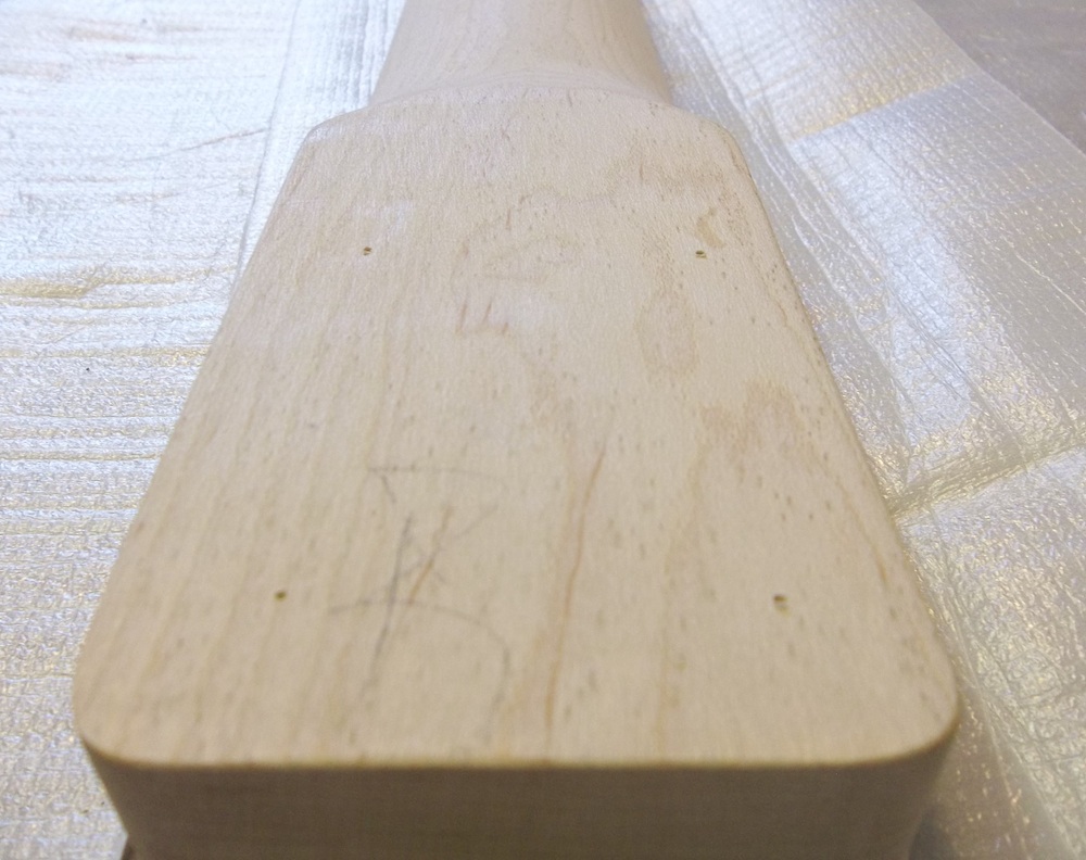

Unclamp the neck and check where the screws will sit. Looks good, none are too close to the edge.

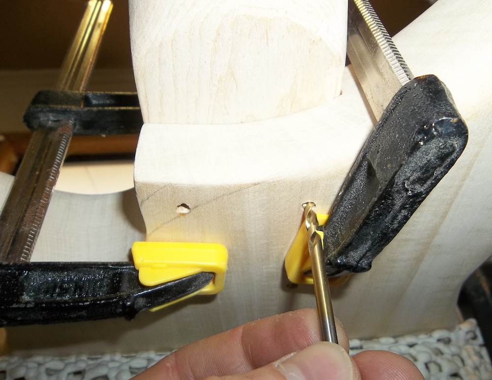

Re-clamp the neck with your centre line, extra work but worth it to get things right.

Check the maximum depth you can drill before you hit the fretboard. In this case 45mm max through body and neck.
