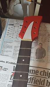

    Day 2:
    I know a lot of you like sanding. I can't see the enjoyment. I know it needs done. I stripped the neck and sanded and sanded.........
    I added a touch of mahogany to the red and got what I was after. The TRC is just for show at the moment.

    Mentor Zandit75's Avatar
    May 2016
    Penguin, Tasmania
    1,617
    Looking good.
    Just keep in mind the tuning machines when shaping the TRC. There is a washer that goes on that might interfere with the TRC as it is shaped at the moment.

    Yes, that bottom E tuner might be slightly problematic. Remember that it's not a strict Rick copy, so you may have to make a few compromises and thin down the width of the TRC near its base.

    I just looked at google and the purists all say no to Bigsby on Ricks. It sure looks nice but the 11 thou strings are a put off. That's baling wire surely. I'm waiting on sealer to dry so the old imagination is running riot, idle hands etc.
    Washer on head is ok by the way, just clears and no more. That was luck not skill.
