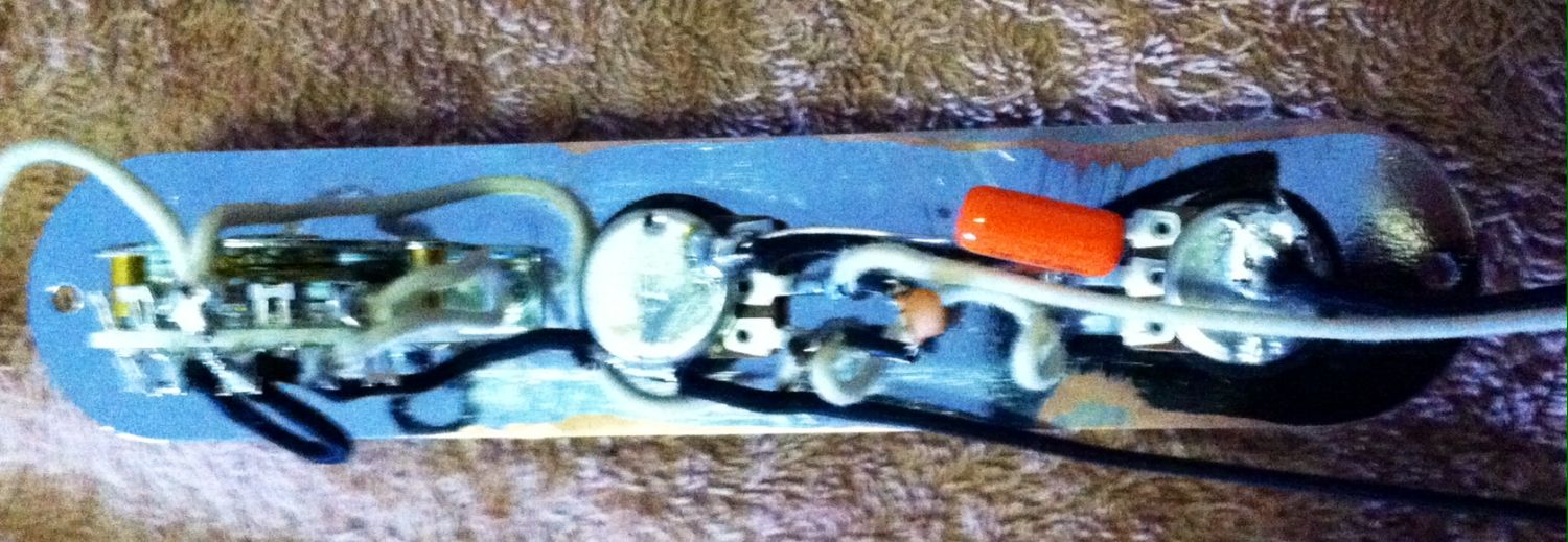

    Anyways, the other non PBG Tele was ready to reassemble so I took the opportunity to wire up the control plate for this one whilst the soldering iron was hot. Also doing a 4 way switch mod where you have to de-solder the earth on the neck PUP and run a separate earth wire through to the controls.

    I've got a 4-way switch on my Warmoth tele. The series mode is certainly a very different sound.
    Hi Simon, yes it is, quite fat and chunky.
    Was just playing the other Tele that I reassembled earlier tonight and flicking back and forth across all combinations having lots of fun. That axe has Wilkinson Classics in it and can't wait to hear what these Toneriders sound like in comparison.
